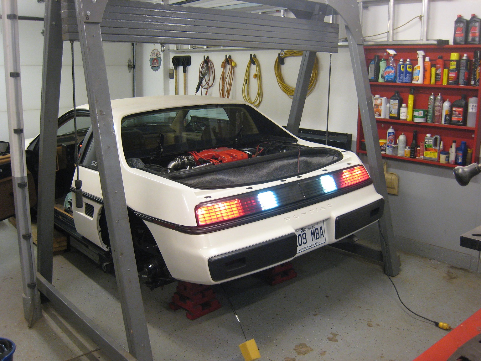

For reference, I activated the brake lamps. The brake lamps are incandescent 2057 bulbs.
In the garage, this setup appears to work. When in Reverse, if I push the shifter towards the right, the back-up lamps stay on. When in 1st/2nd, if I push the shifter towards the left, the back-up lamps remain off.
Once I get the car on the road and some mileage on this setup, I'll be able to recommend this as a solution to the common back-up lamp switch problem, whereby no adjustment of the the stock switch can allow the system to work properly.
