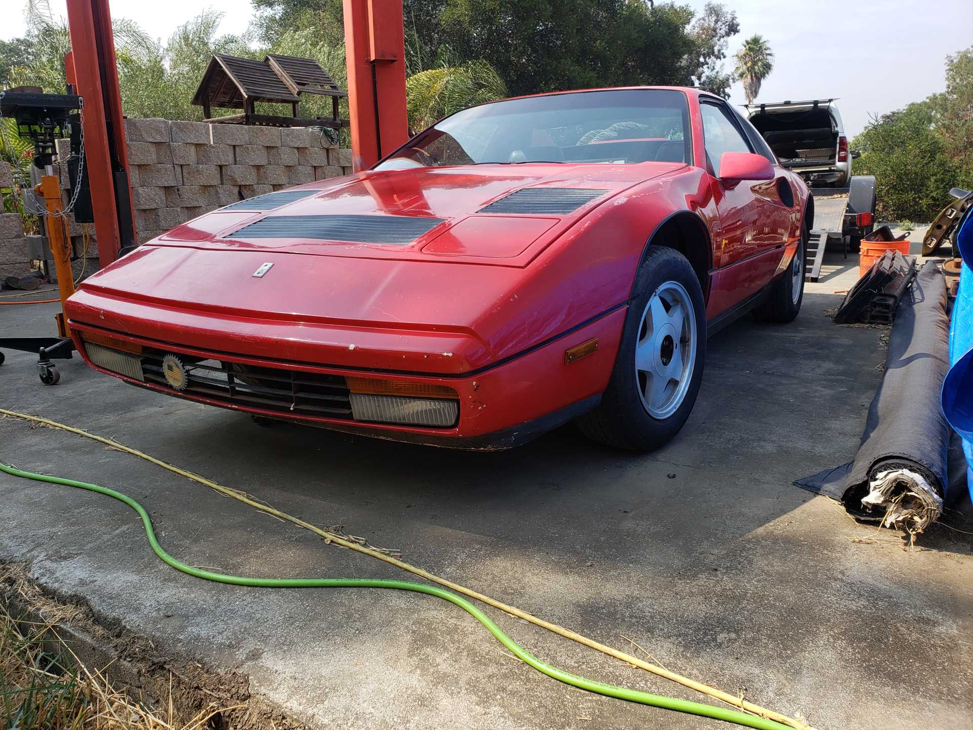

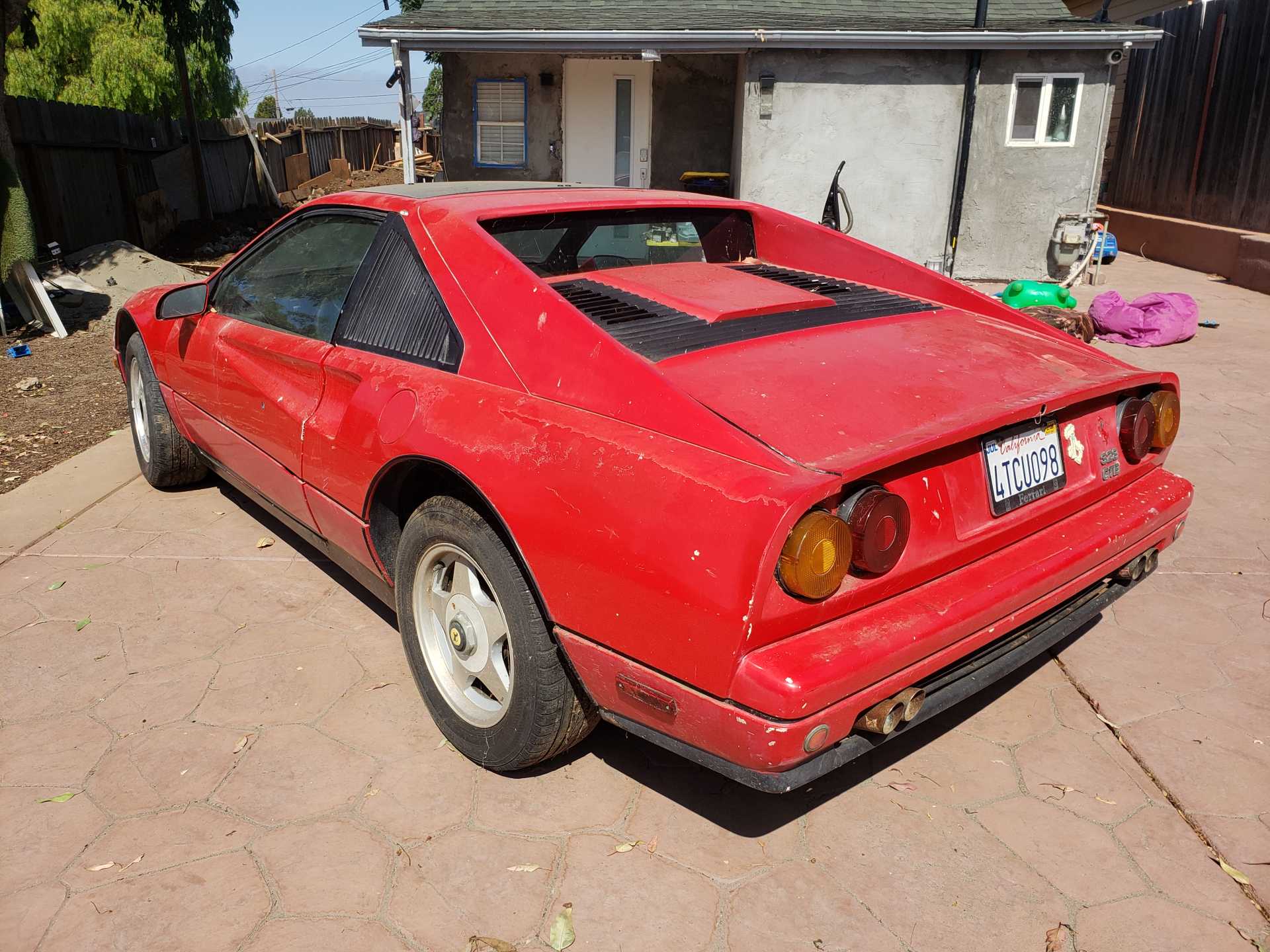

Well, I finally brought it home saturday morning, in all it's non-running glory, the more I look at it, the more issues I see that need fixing, there are several cracks in the hood, and a couple around the roof, the driver's door has to be opened from the inside, the driver's window has a HUGE gap at the back, the whole nose sags if you look at the body line down the side. All in all, STILL AWESOME! at least to me. Isn't that what counts? I PMed Rick today and he replied fast, I also found a PM from Eric, here in the Bay Area, I replied today, sorry for the month plus delay, I never saw it. Thanks Guys, for the time given to communicate. I don't expect this build to even start until next year, I may devote a few hours to getting the car running like it is, but I have a LOT, I MEAN S**T-TON of projects to do before this is really worked on. I thought it was an 88 before, but discovered it is an 85 GT, has a 2.8, auto, and power windows, i think it has A/C and maybe cruise control. It hasn't been on the road(at least legally) since 05 .
The future plans for this car are as follows. 88 rear cradle with an aluminum LS V8, better brakes, Coilovers, and lowering, with way wider rear wheels/tires (look at that kinda wide-body quarter).
I have not decided yet whether to go LS4/4T65E, or LS4/F40, or LS1 or LS2, with the Archie adapter and F40, I could even do the L33(Aluminum truck 5.3) Or I could de-stroke an LS4 with a 3.3 stroke crank(4.8 liter stroke) and make a 9000 RPM ripper with forged parts. The possibilities are endless, Is there anyone who has done the Archie LS conversion, so I can learn how it went? The kit is expensive, but the custom LS flywheel for the LS4/F40 isn't super cheap either. To get it to pass smog here in Lovely California, I would have to use an auto with the LS4, or use another LS from a manual vehicle, and use all the emissions equip, computer etc from the same car, I could maybe pass off the LS4 block for an LS1 or LS2 and do the manual that way. I have an 88 donor car coming with a manual, and no engine, so I'll have a stock set of manual pedals. I may also have another 85 manual car coming with no engine or transmission, that will most likely be for sale pretty quick, I will make sure anything I need for my kit car comes off it first though.
