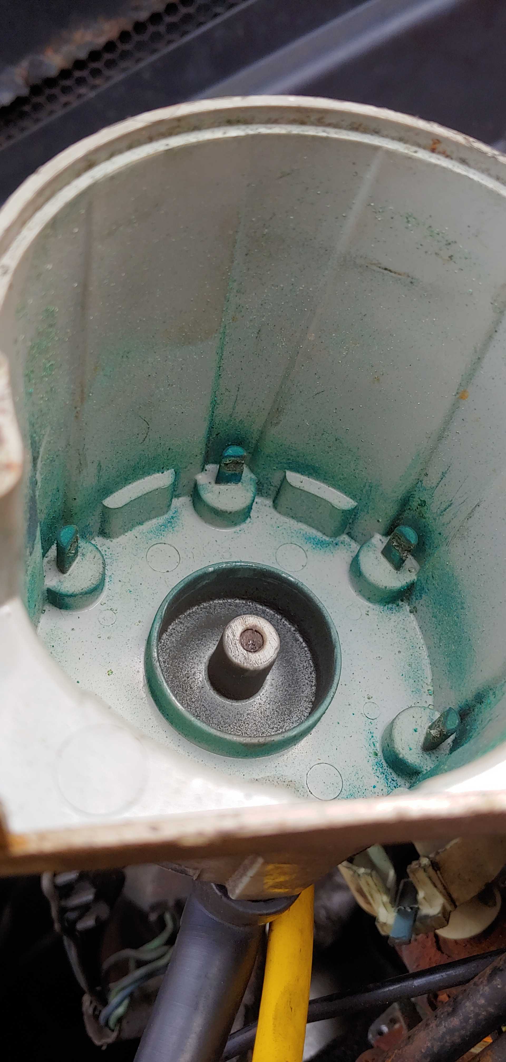

I had a look inside the distributor cap and saw this:
I'm not sure if you can see it, but the pin in the middle is actually recessed so I'm pretty sure it does not make contact with the rotor arm.
Could that cause the problem?

You could try cleaning the perimeter posts - they look a little worn... & get the dust & debris out. I've done that many times in the last 36 years to eliminate mis-fire issues. It frequently delayed replacing the cap for months/years.

Replaced the distributor cap and rotor today. The first few minutes it seemed that the problem was still there but after the engine heated up a bit, it was almost completely gone. Only every now and then there was a slight sputter. So the increased spark seems to have helped a bit.
