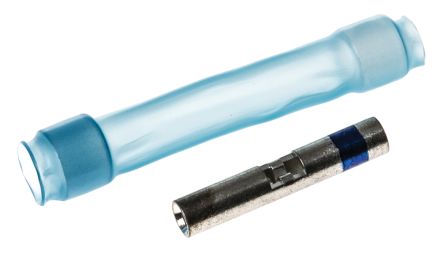

If you want to check wire connections but can't get at the end of the wire/connector, use a pin and slid it thru the wire. Also, for splicing wires they have "Environmental splices" which have a shrink tube that seals them....The ones you can buy at the auto-parts stores are ok, but the Aircraft ones I use have epoxy in the ends that melts and completely seals around the wires. Raychem makes them but they are expensive......
