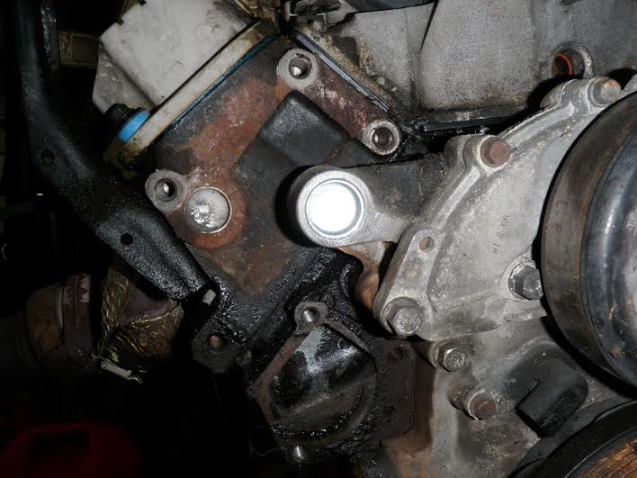

Has anyone set up their 3800 swap using a modified Fiero thermostat bracket? If so where did you connect your heater core lines to?
Thank you, Matthew
fierosound
AUG 14, 11:40 AM
Port circled in red is the suction side of the water pump. Your heater return hose should connect there.
Matthew_Fiero
AUG 14, 01:42 PM
| quote | Originally posted by fierosound:
And instead move the cap to the port under the LIM?
AUG 15, 07:50 AM
Matthew, both of the ports you are using for your heater core hoses are pressurized.
The port on the front cover should be used for the heater core return line, and the port below the snout should be plugged.
Matthew_Fiero
AUG 15, 09:12 AM
The port on the front cover should be used for the heater core return line, and the port below the snout should be plugged. |
Thank you. This is the way I had it when I first built the engine. I'll switch it back and report back. My hose is too short now to reach back to the timing cover so I'll have to go purchase another length first.
Thank you again for everyone's input!
