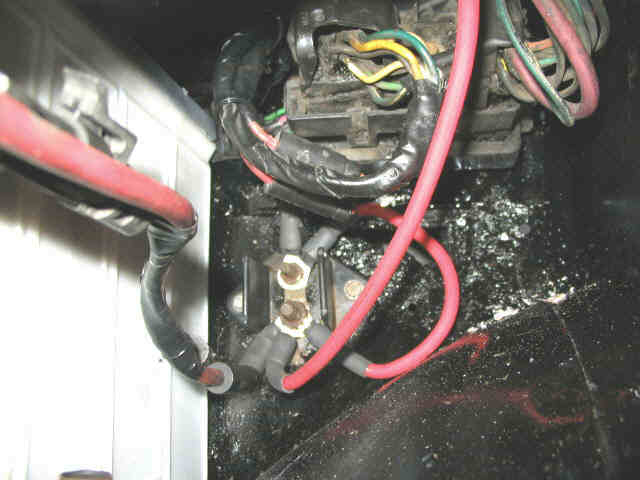

Thanks larryinkc, not sure of the location of this terminal block?
Its on the right rear inner fender just after the battery.

Clean/fix + wire above and All "grounds" bolted to engine and engine bay. Coat w/ Silicone or Brake Grease to stop future damage.
Even if isn't the root problem now... will be problem because of iffy "grounds" etc. After solving current problem... Do same for other grounds in the cabin and front of car. They often need cleaning/fixing too. See my Cave, Wire Service
