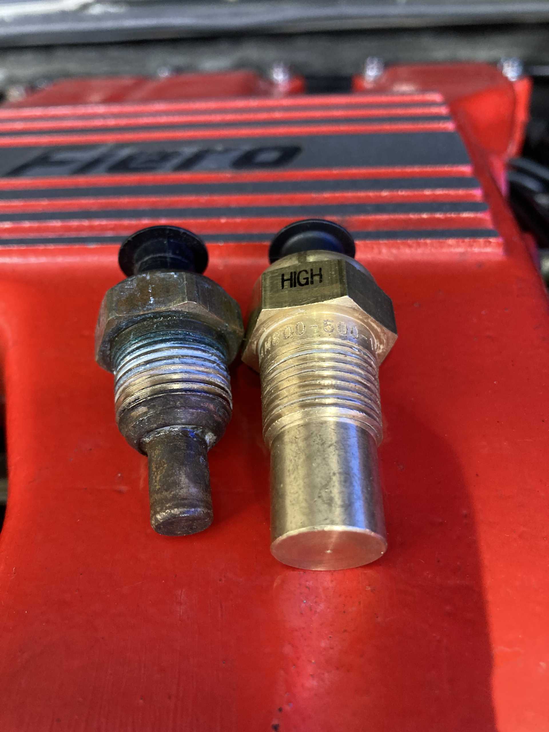

Hey Patrick, finally got the 210 fan switch from Dickman's…. Doesn’t even come close to fitting. I have the 1986 2M6…. Advice? Check the attached pic…[This message has been edited by branger (edited 10-10-2021).]

quote | Originally posted by branger:
I have the same fan switch, yes its supposed to look like that. The threads are the same so just screw it in and dont think about the sensor size difference

Correct, the aftermarket fan switch bottom that touches the antifreeze is larger that original (thread size same) and that 210 fan switch is actually closer to 215 ON and 205 OFF which I like even better (original is 235 ON). Its also worth noting, most folks use a 180 stat with that 210 fan switch, but you can still use the stock 195 stat. The 180 stat will average only slightly cooler temps (5 to 10 degrees) and slightly richer mixture than 195 stat, which is exactly what I want on my 36 year old engine approaching 100k miles with carbon buildup, and fans never let temps exceed 215.

So one important point to note when I installed the newer one, with the thicker brass bottom. It did not seem to fit as the base was thicker and I didn’t realize both original and replacement had the same thread size/diameter. I think with the fatter brass base, there was no room for coolant displacement. I then, took some paper towel and took some coolant out and new sensor fit fine. Hopefully it will do the trick. I’m gonna wait 24 hours for the thread sealant to harden before testing. 🤞
