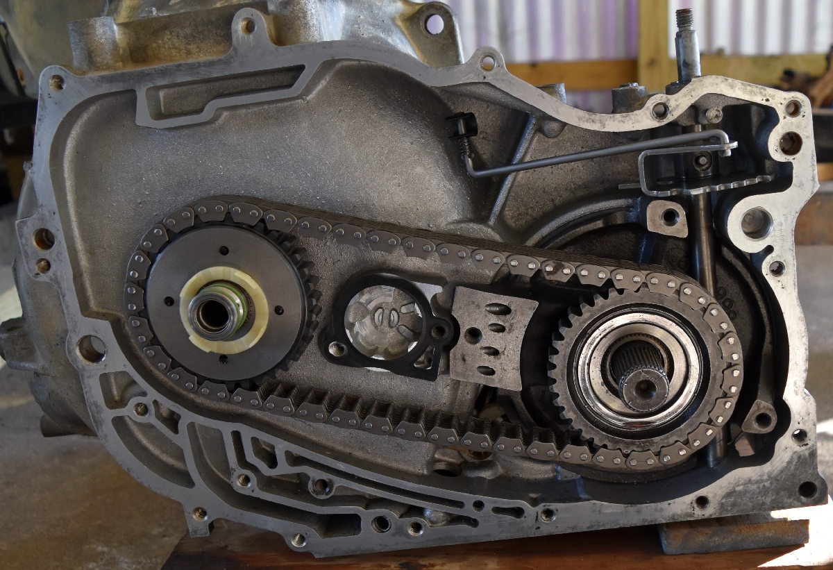

UPDATE: I have the transmission reassembled. I took last weekend off and went camping. That was part of the delay. This trans rebuild was harder than I thought it would be and took longer than I expected. But, it's done now and I feel confident that it's ready. I replaced the drive chain, intermediate band, sprag, clutch discs, steels, seals, gaskets, pump parts, TV cable, etc. I installed a shift correction kit and put an extra friction disc in the direct clutch pack. Next, I'll mate the engine and trans together on the cradle and get it ready to reinstall.
The old chain had 3/4" of slack and the new chain has 1/4" of slack.[This message has been edited by batboy (edited 10-12-2021).]
