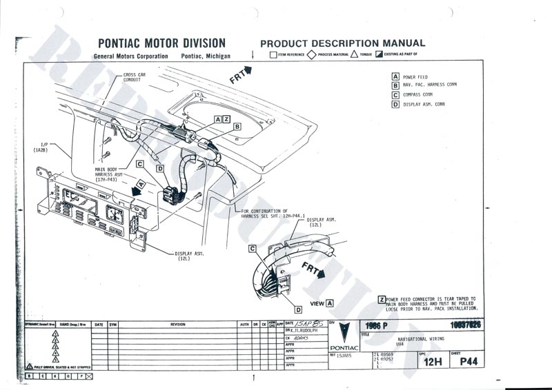

The only thing I could find in the manual was this:
Our FSM must be revised, both our Chapter 8 pages are denoted as 8A.
The archived post had a number for the pages in Chapter 8 that was 8 - 87 - xx.
sanderson231 MAR 09, 05:23 PM
Stumbled across this thread looking for something else. The connector in question is the C211 which connects the pigtail for the Rally Gage (not computer). The Rally Gage is the oil pressure gauge and volt meter above the HVAC controls. GT models always have the Rally Gage. Some other V-6 models as well. Not present in 4 cylinder cars.
formerly known as sanderson
1984 Quad 4
1886 SE 2.8L
1988 4.9L Cadillac
1988 3800 Supercharged
