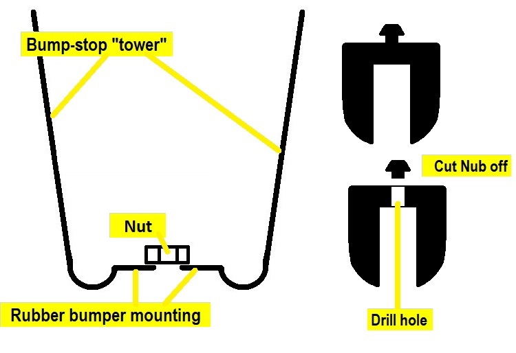

I just came up with a diagram of what I did...When I tried to remove the rubber bumpers before my buddy welded the tubes back together, the nub came off one of them. I bought the poly ones but was not impressed with how hard they were (Even after drilling some holes in them to make the initial contact softer)....Went to the JY to get some more of them- both had the nubs come off.
So I came up with the idea of making them "Bolt-on"........

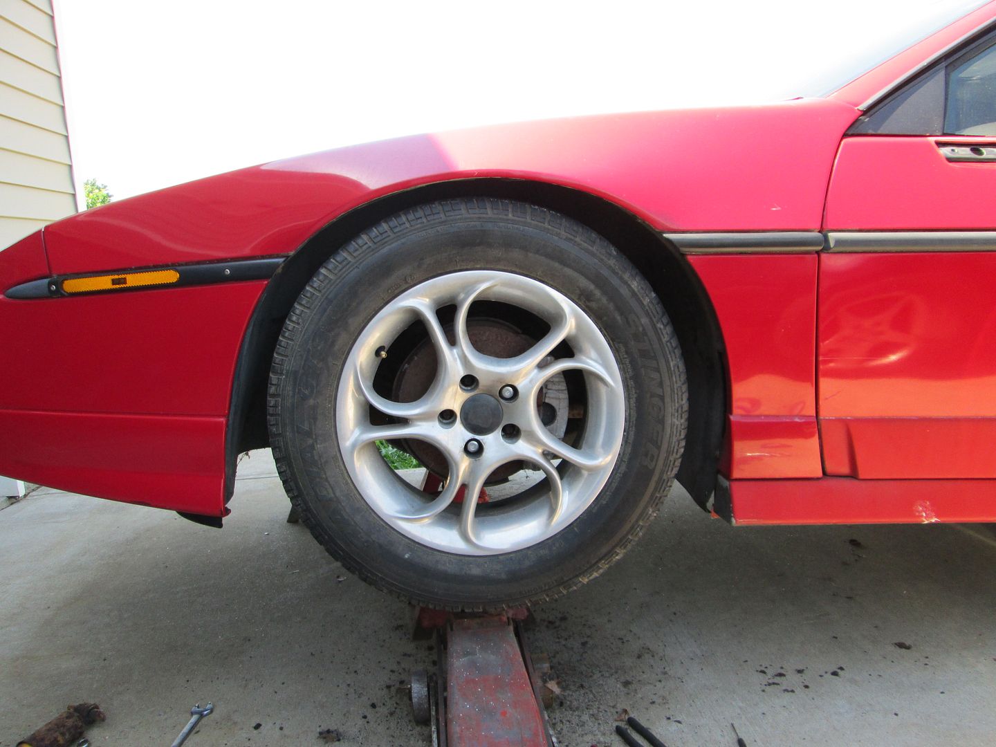

Originally posted by Signupacct: I have run into 5 1/4 inches as the hieghth in three places
Would the bumpstop height be a function of inside wheel well and tire dimensions
and therefore the same no matter the year the model and the engine
otherwise I need to wait for someone with a 1987 Fiero GT V6 to measure their's to confirm that 5 1/4 inch is the
dimension to go with
You should measure your wheel gap to the fender and see how much room you have for the bump stop. Here is a picture with the front suspension resting on the bump stop on an 84-87 fiero.
