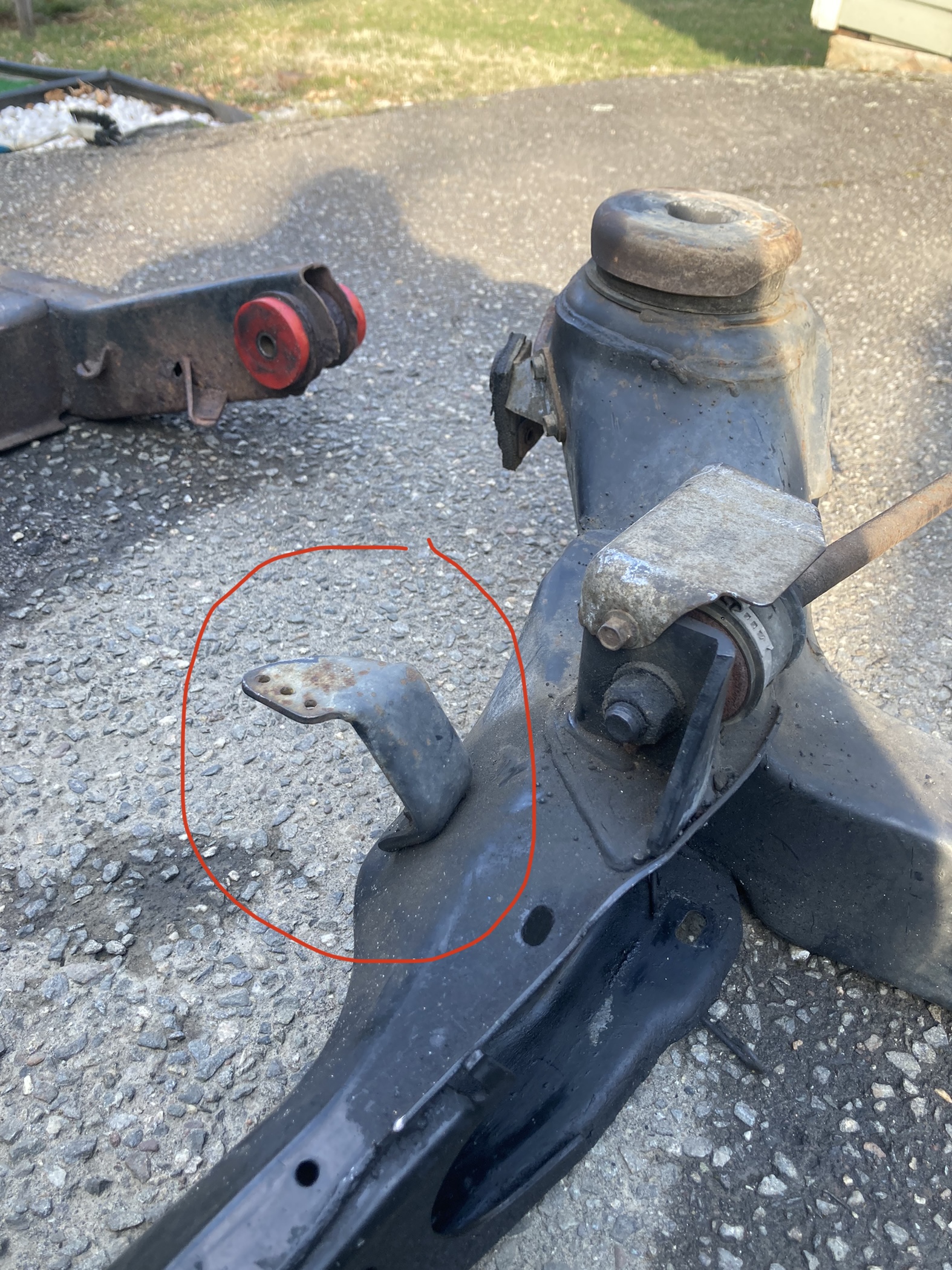

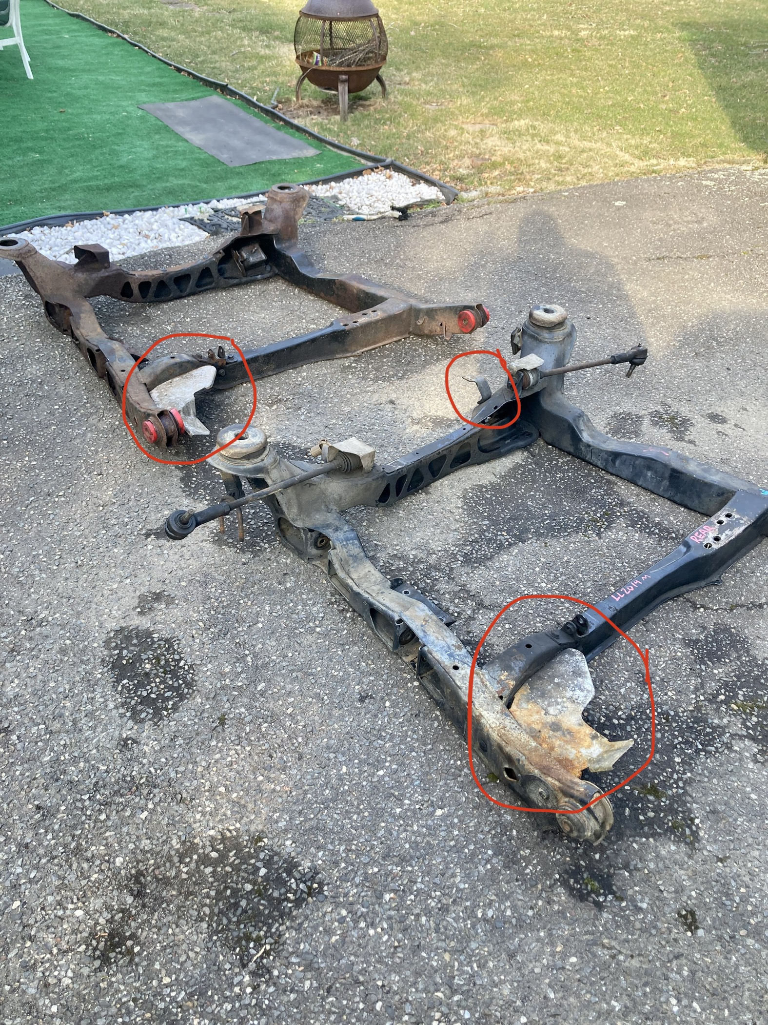

 so i got a replacement cradle from an 86 gt. (shown in foreground of second photo). its identical except for the sheet metal bracket on my old 87 is bent down, where the 86 is bent up. i suspect my old one is just bent. what is this bracket used for?
also there is a smaller bracket on the 86 that was not on the 87, what is this used for?[This message has been edited by gregr75 (edited 03-19-2023).]

The silver sheet metal is an exhaust shield. That smaller metal piece in the foreground, I am not sure as I have never seen that. Maybe it's on the 4 cylinder cradles only? Someone else should pipe in and tell us though. It almost looks like an exhaust hanger thst was put on later. [This message has been edited by Spadesluck (edited 03-19-2023).]

it looks like theres holes to accept that small bracket on my old cradle too..
A_Lonely_Potato
MAR 19, 01:28 PM
quote | Originally posted by gregr75:
this bracket is for the muffler hanger springs

where's the rusted out parts on your old cradle ?
edit - you have more than one replacement cradle? I saw your older thread. There must be something about that specific part of the cradle that loves to rot. My GT broke there, and my replacement cradle has damage there, also[This message has been edited by ArthurPeale (edited 03-19-2023).]
MAR 19, 07:02 PM
quote | Originally posted by ArthurPeale:
I don't know where you're referring to... but I'll guess it's below the factory battery location!
ArthurPeale
MAR 20, 11:27 AM
Opposite side, actually. This is the photo posted in the link you referenced
 My GT was similar, and the cradle I got to replace it has the beginnings of rot at where the bushing sits.
