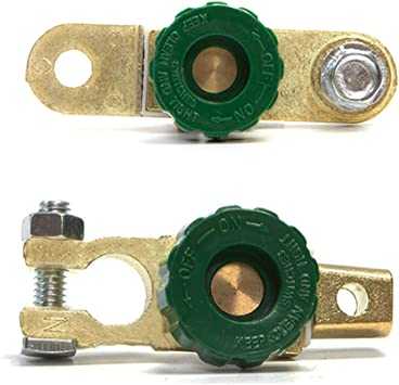

I've had one on my '84 Fiero and on my Subie for years, but just within the last month I think they've contributed to some weak battery issues with both cars. I suspect because of the added contact surfaces involved, corrosion was eventually able to cause poor continuity between parts of both switches. Perhaps some preventative maintenance with some dielectric grease would've prevented any issues, but it's something to keep in mind if using one of these switches.

I've had one on my '84 Fiero and on my Subie for years, but just within the last month I think they've contributed to some weak battery issues with both cars. I suspect because of the added contact surfaces involved, corrosion was eventually able to cause poor continuity between parts of both switches. Perhaps some preventative maintenance with some dielectric grease would've prevented any issues, but it's something to keep in mind if using one of these switches. |
Big problem is most are made of Zinc and other cheap metals and "rust" or even break. And includes many sold by car parts stores so not just Amacon or Eflay problem.
Same problem happens to "Switch type" discon's that "look like" ones made for race op's that often have Cert's saying made for the job.
Jeggs and other make real brass parts costing ~ $30 that won't rust or break easy but in Fiero w/ wet location for the battery likely still need Dielectric or Permatex Green Brake Grease to keep out road "water," washing the car, etc.
I coat most ends bolted/screwed to engine etc w/ PBG for same reason including battery cable ends.
MAY 31, 09:41 PM
...in Fiero w/ wet location for the battery likely still need Dielectric or Permatex Green Brake Grease to keep out road "water," washing the car, etc.
Whenever I remove a bolt on my cars, I apply a bit of anti-seize to the threads before re-assembly... and every time I disconnect an electrical connection on my cars, I apply a bit of dielectric grease before plugging it back together... but did I apply anything on the connections of my battery cutoff switches? No. I'm not sure what happened there!

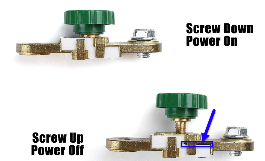

the cutoff I am using is an el-cheapo from Amazon. They work, but the problem I have with them is when loosening the knob to disconnect the battery it is sort of hit or miss. see photo. In theory, as you loosen the knob the contact plates separate and remain parallel to each other negating the need to fully remove the knob to disconnect the battery. In practice, the contact plates do not remain parallel requiring me to remove the knob fully as the only way to be sure the battery is disconnected.
That aside, I agree use of disconnects do work well.

| quote | Originally posted by sjmaye: In practice, the contact plates do not remain parallel requiring me to remove the knob fully as the only way to be sure the battery is disconnected. |
Another reason to buy good ones...
Cheap ones can to that and worse because the "ears" won't hold the half sections. Now it is loose and moves but can fail and battery side gets expose so easy to short the battery that dumps 100a or more.
