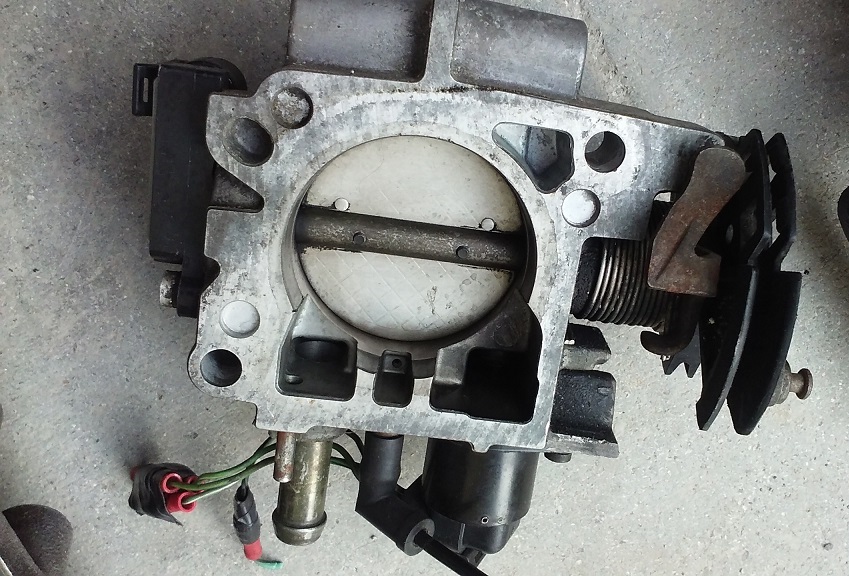

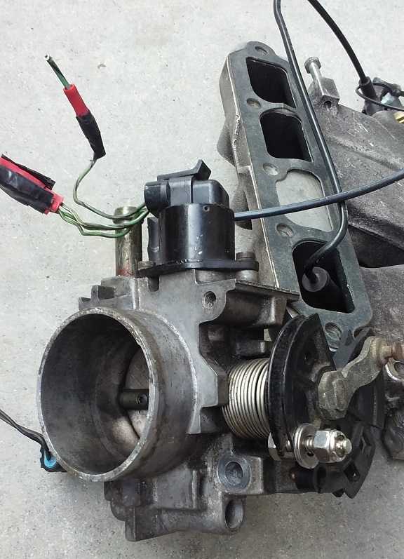

The cvxjet modification is called the Dawg mod. He might still do those. Around here machine shops that weld like that charge $90 per hour and none convinced me they could do it reliably. Sad. This one I have is an alternative form to get around the neck restriction. The builder used a DIS setup like the Camrobird 3.4 setup as you can see the coils on the right side of the full engine shot. $50 bucks plus shipping and it's yours. Here's the shots of the TB it had on it. Someone should be able to recognize it or it could be sized by the opening and bolt pattern. Using a stock Fiero TB when this was built would be a big miss, so I'm sure it's larger. It appears to be a Fiero intake, and it's a straight-shot design now. No throat to choke,

PM sent. Just to reiterate, what was the issue with the TB not being included? You said it was too expensive to mention? So it's not for sale? Or you just feel like whatever number you put out there would melt my face off? Or did I misunderstand completely?

Also Sourmash, can you measure the opening of the intake? It looks like it matched the throttle body. That would help me narrow down what it was. I wonder is a stock fiero TB has enough meat on it to port it to match. Also, I think I get it now. I was too expensive at the junk yard so you left it.. [This message has been edited by SpaceLion (edited 04-04-2020).]

APR 04, 01:11 AM
Correct. It was 35 or 38 bucks. Their prices on some things aren't too good. Others are.
