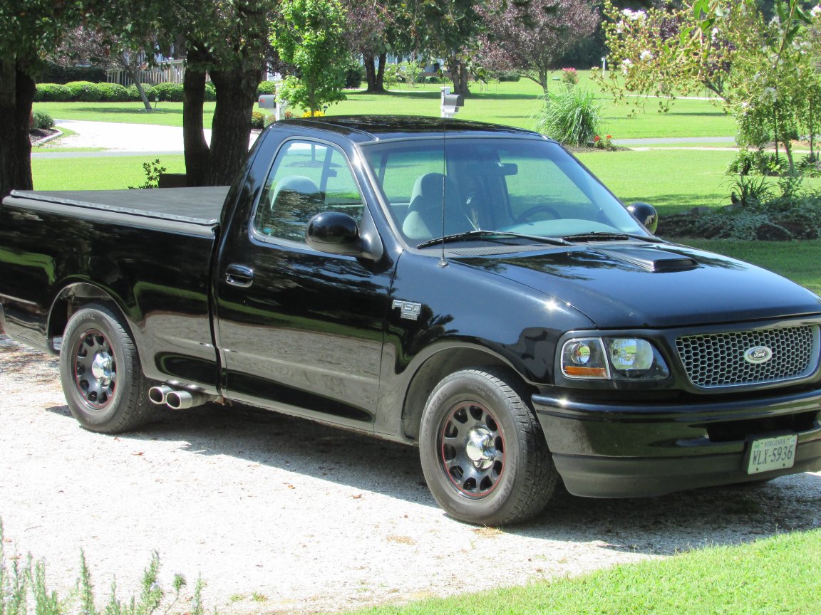

Besides, If I need to burn rubber I take this beast out -

Besides, If I need to burn rubber I take this beast out...
Heh heh, I'm not into burning rubber. At appropriate times (like at autocross). I just want to get going quickly from a standing start.
