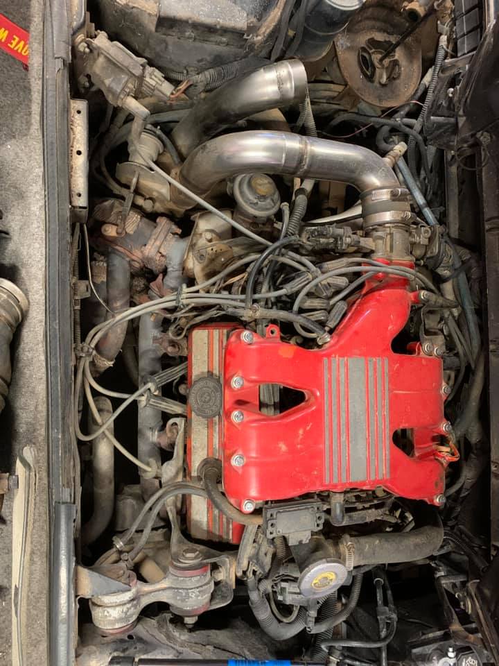

SEP 04, 12:27 AM
Design One turbo kit. Ugly but works!
