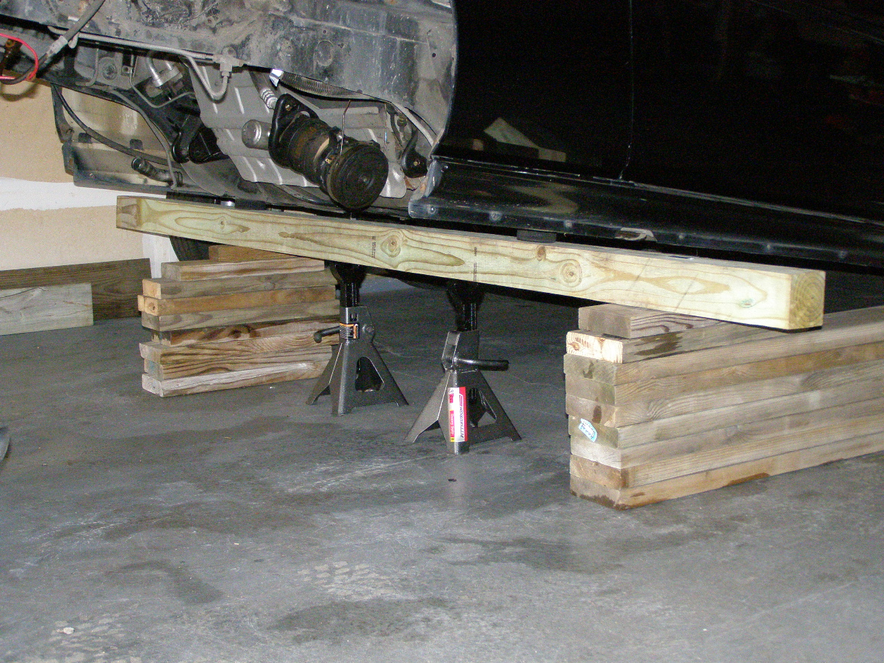

here is the car sitting on blocks with the cradle removed, note the hockey puck which gives a little stability over wood, also note the wood is supporting the 4x4, the jack stands are backup, always use two methods of support

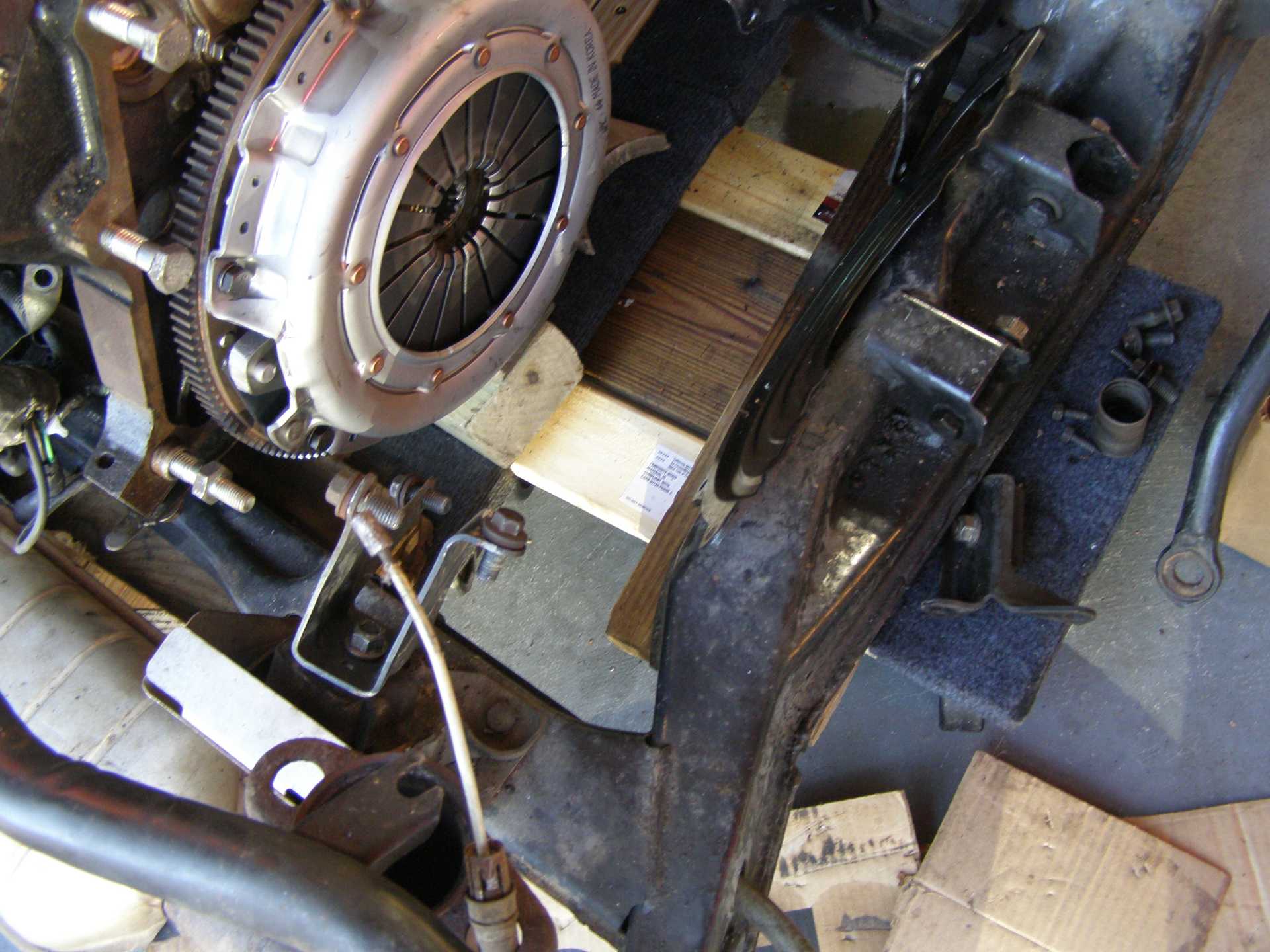

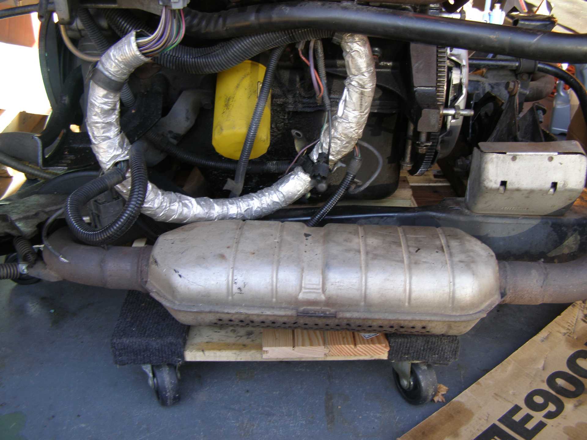

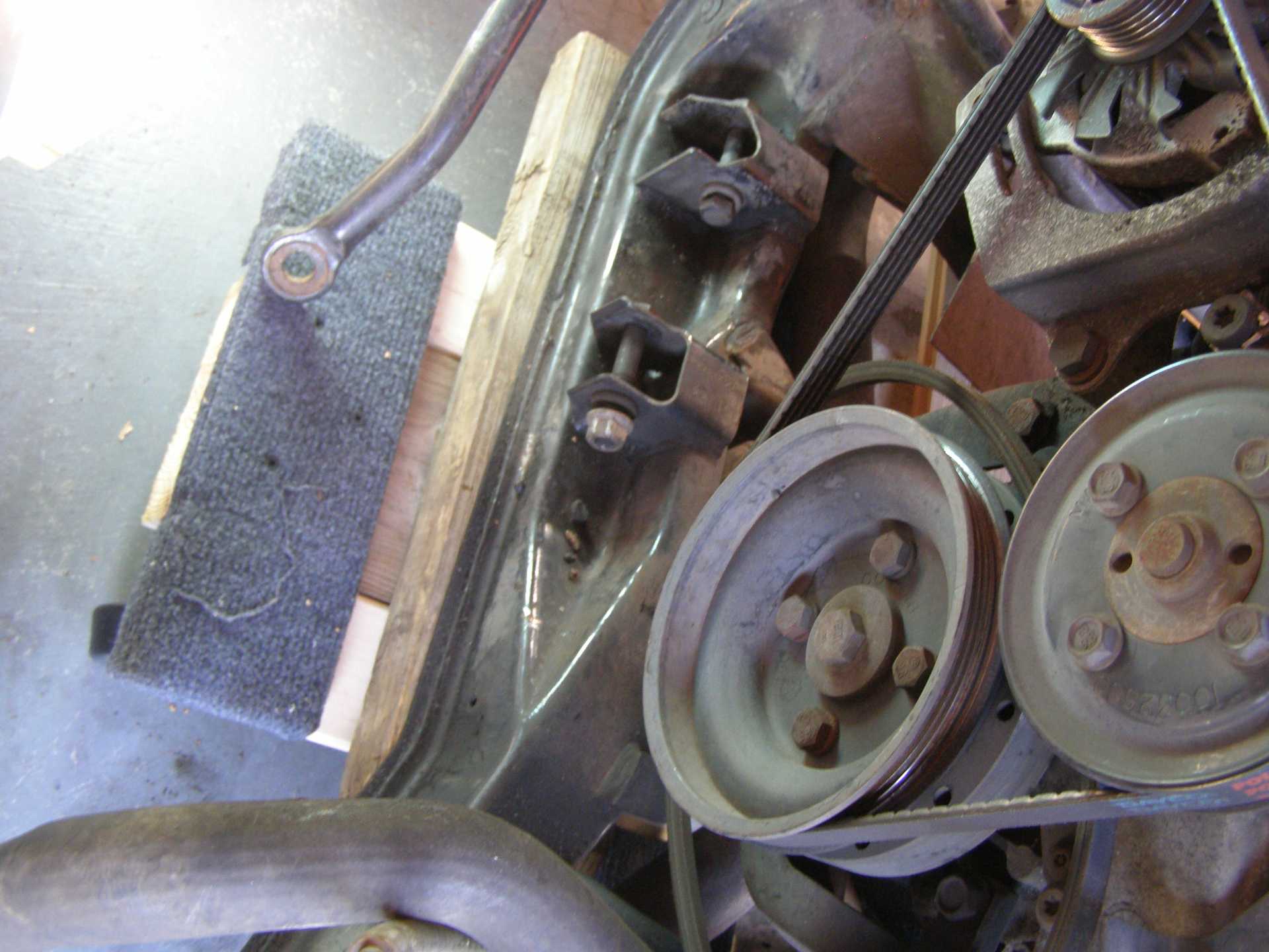

using this method the cradle comes out the side {mud guards must be removed, which is good to do}, I cannot show a pic of the cradle support I assembled, because the cradle is currently sitting on it but maybe I can capture a pic that will give an idea of how the dollies are constructed, the 1st time I used just two, but added the fourth tjis time for more stability
