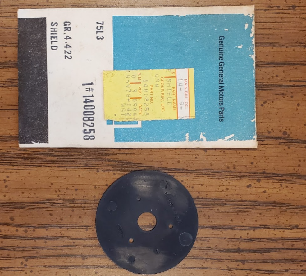

I wouldn't trust the normal ABS wire-filament type stuff, but nylon (often glass-filled) is often used for parts bathing in hot oil.
Nylon (with glass spheres even) can be printed using selective laser sintering.
SLS parts can be nice enough that I think I'd be willing to try that route.
A 3D-printing shop that does SLS could probably do this part for less than $100 or so.
The disc is a loose fit IIRC, so there are no fancy tolerances needed. It's quite flat too, so I think the part is a good fit for SLS nylon.[This message has been edited by pmbrunelle (edited 05-10-2021).]

Part came in! Just waiting for the shim i ordered now.
