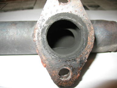

This photo taken from an old porting thread shows the factory restrictions which we were targeting for removal.
It's the hogging out of the ports to match the gaskets which is what's probably responsible for the flanges often needing to be re-welded. Limiting the porting to just removing the internal restrictions doesn't seem to create this issue... and it's a heck of a lot less work.
