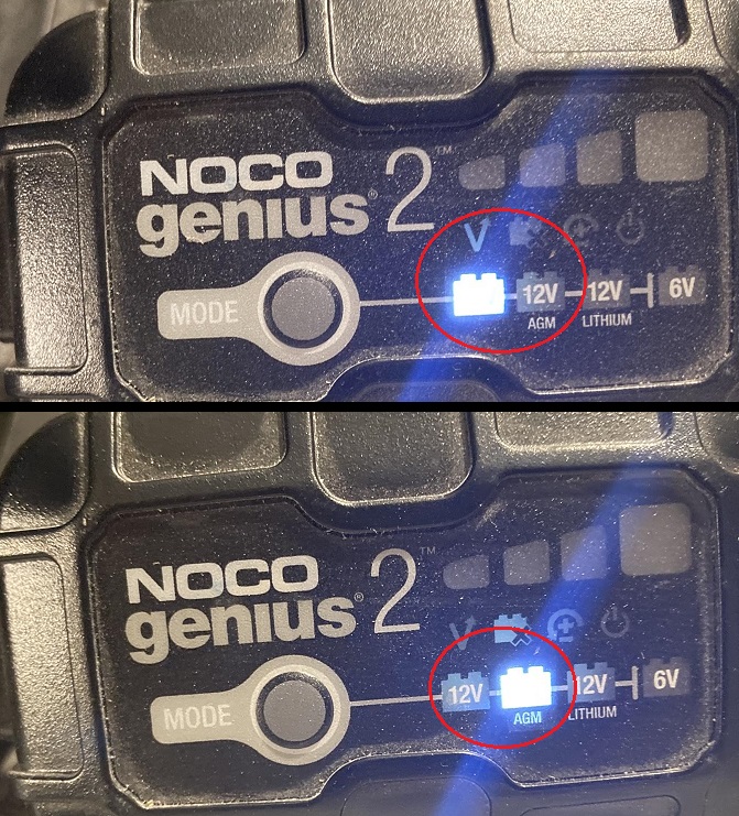

 Turns out that Optima Batteries are "AGM" batteries, of which I was not aware. When I got a new alternator, before I started it I switched my trickle charger to "AGM" mode and let it charge overnight.
 Turns out my trickle charger was never properly charging the battery because it was in the wrong mode (probably what led to my alternators dying repeatedly). Now that it is charged up, when running the car I have a perfect 13.8-14v. Thanks all!
