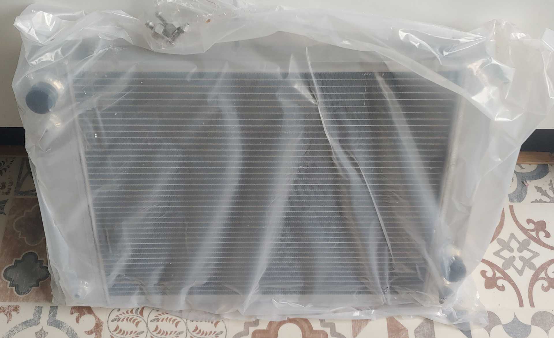

My radiator has arrived! That was a whole lot quicker than expected. 8 days from China!
It was well packed and it looks good quality wise. I ended up paying about $220, including shipping. Not sure if I will get a bill for VAT and import taxes, but I suspect not.

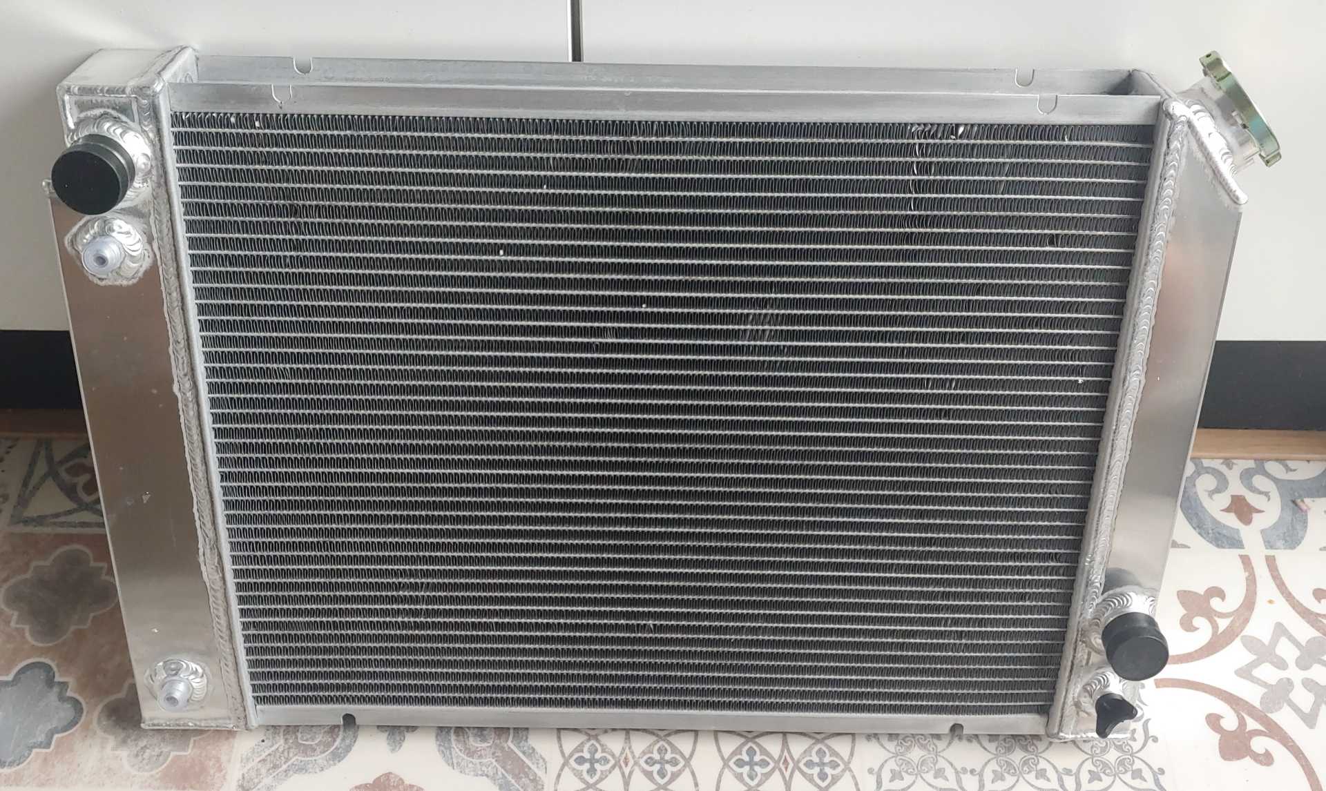

That said, I think I could have done it in 2 hours at most if I used an OEM radiator. But as it turned out, this thing is not a drop-in replacement.I'm not sure if they send me the wrong one because other than it not fitting, the couplings for the transmission lines were different too.

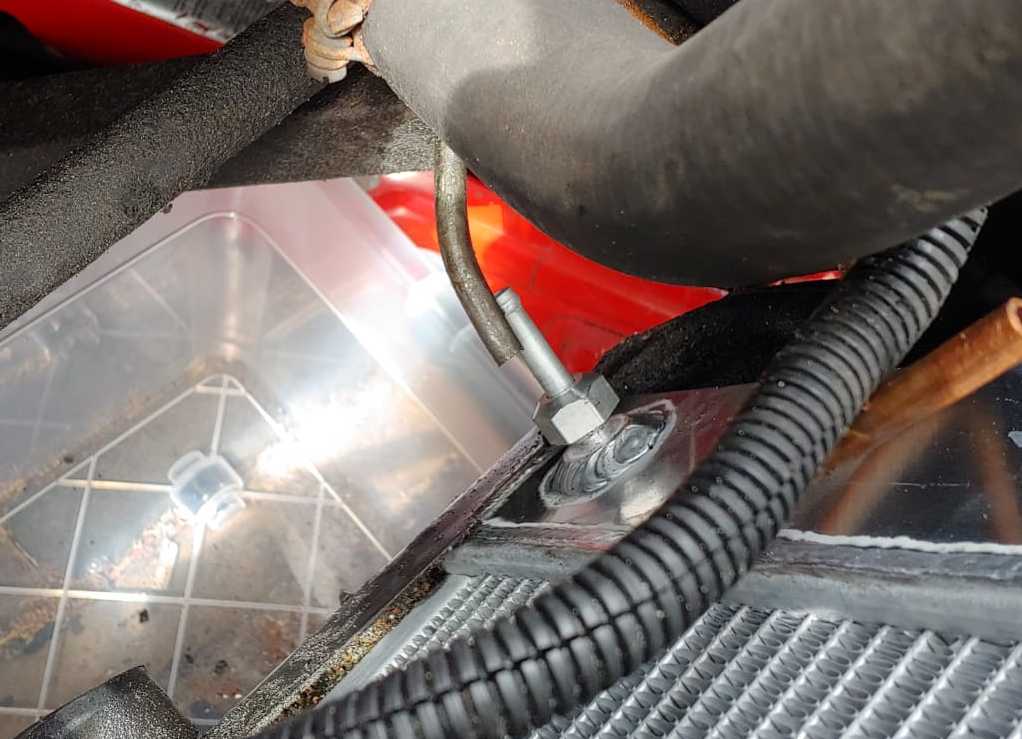

Removing the rubber hoses was also no problem, but the transmission lines was something else. The top one came loose easily. Although I only now noticed that apparently someone tried to remove the transmission lines before (maybe during the repair I had done last year?) and the lines had broken because both the top as the bottom line had a piece of the line replaced by a rubber hose. Not sure why the top one had a piece replaced since it came off easily, but the nut of the bottom one was rounded. So I suspect they cut it and used a rubber hose to connect the piece that was stuck to the radiator with the rest of the transmission line.

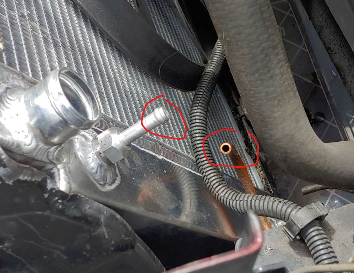

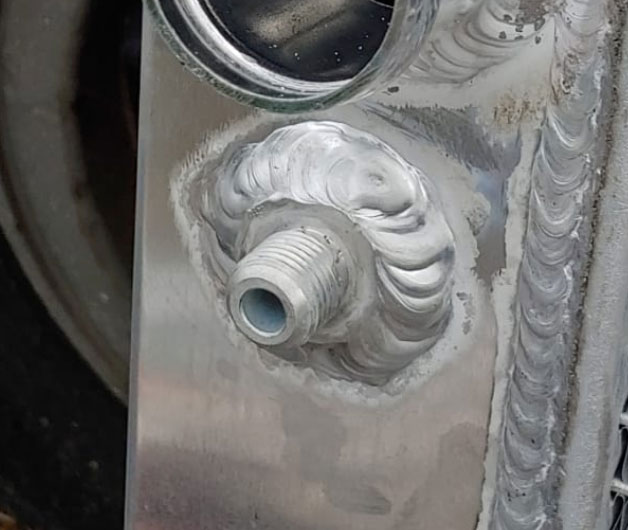

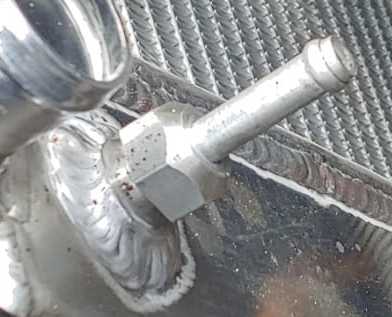

When I wanted to insert the new radiator, only then did I notice that the couplings were incorrect. The pictures on AliExpress showed te correct ones:

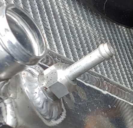

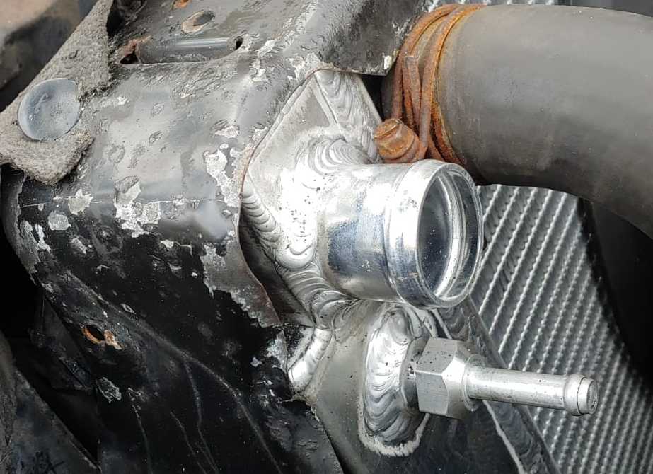

but what I got was this:
It did come with "adapters" so you can put a hose on it:
and since both transmission lines are cut anyways and I need to use hoses, I can make that work I think.
But then... Like I said, this is in no way a drop in replacement. Since it's a 3-row radiator, it's a lot thicker. I knew that because that was mentioned in above video (where they replaced the OEM radiator for the same one as I have). I also knew that I needed to trim the rubber bumper pads which I did. But it still wouldn't fit.

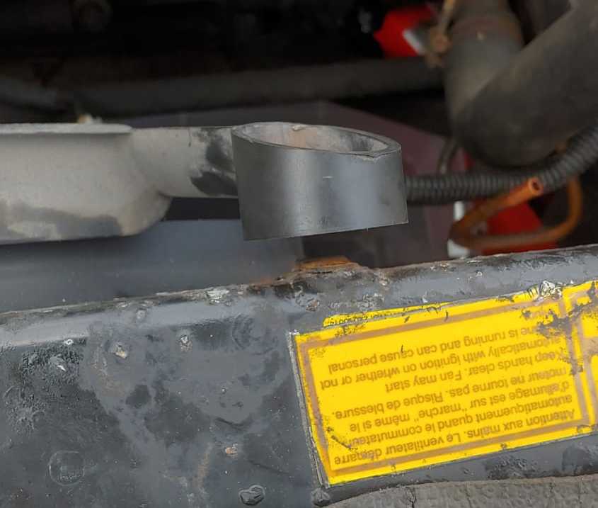

The reason why it wouldn't fit is because the OEM radiator has rounded corners while this aftermarket one has square corners. So the bracket no longer fits. So what I did was "reshape" the bracket (bent some pieces straight, and making the corners as square as possible). I was then able to fit the bracket over the radiator but it was "floating" in the air about an inch above the bolt holes. I had to remove the top and bottom rubber pads. It still had a gap of about half an inch so I just put all my weight on it, tried to align the bracket with the holes and put the bolts in just a little bit. I then tightened all the bolts causing the bracket to snugly bend around the radiator. But it's now metal on metal. No rubber padding. But it's so incredibly tight that I don't think that's a problem.

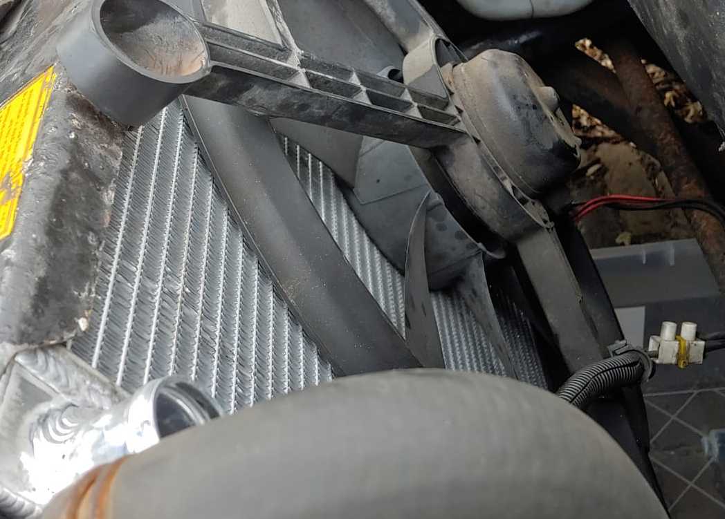

But, because the radiator is wider, there's another problem. There's no room for the radiator fan anymore. If I would bolt it into place, it would bury itself into the side of the radiator.
This is the distance it has when it sits against the radiator:

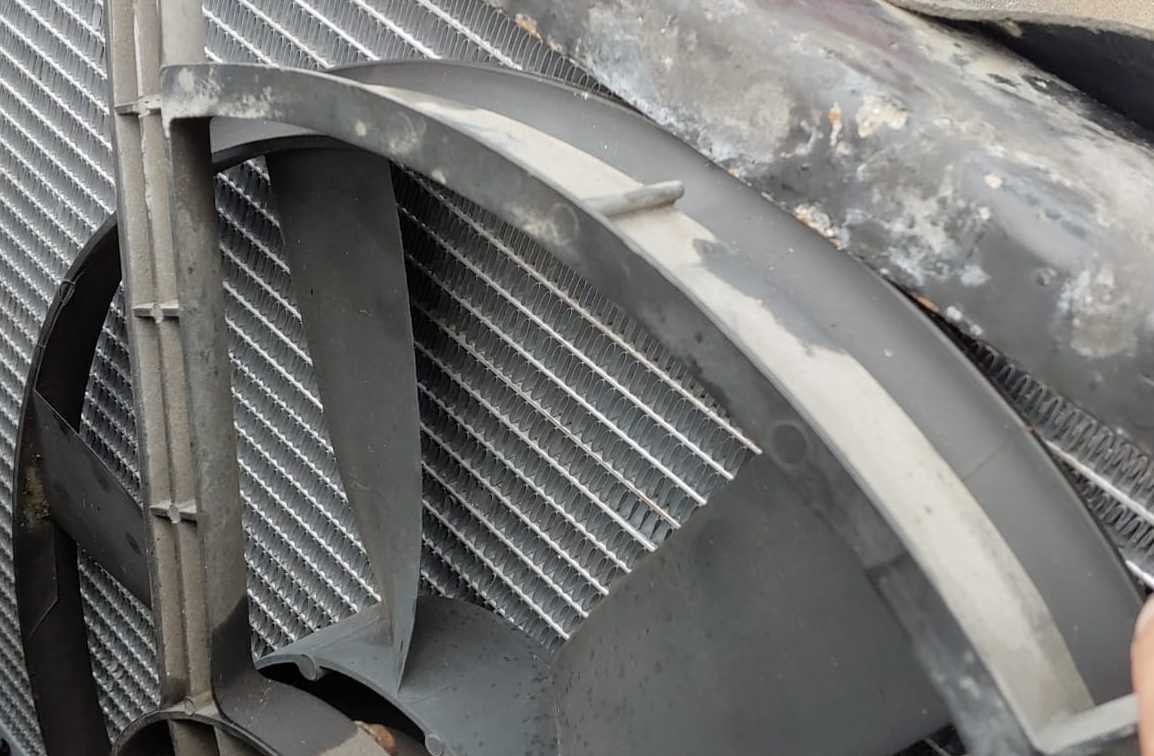

So I need to put some spacers there to move it back. But then there's another problem. Move it too far back, and the fan hits the top bracket:
So not sure what to do there yet. Perhaps I will be able to get it just right with the proper amount of spacers. Maybe I'll just get my grinder and remove a small part of the bracket so the fan has a bit more room at the top.
Now back to the transmission lines. I need to couple these two together:
And also these two:

As for the old radiator, this is how it looked...

I just rewatched the above video again and two things I noticed:
1) He has an aftermarket fan 2) His top bracket has square corners
