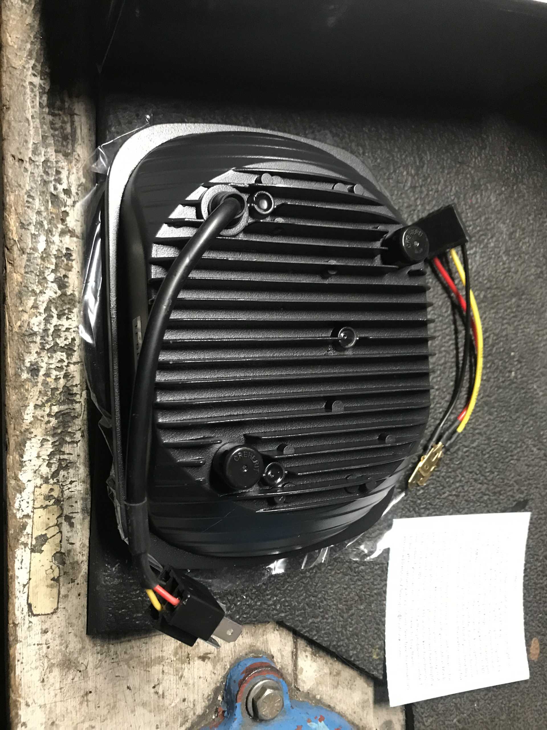

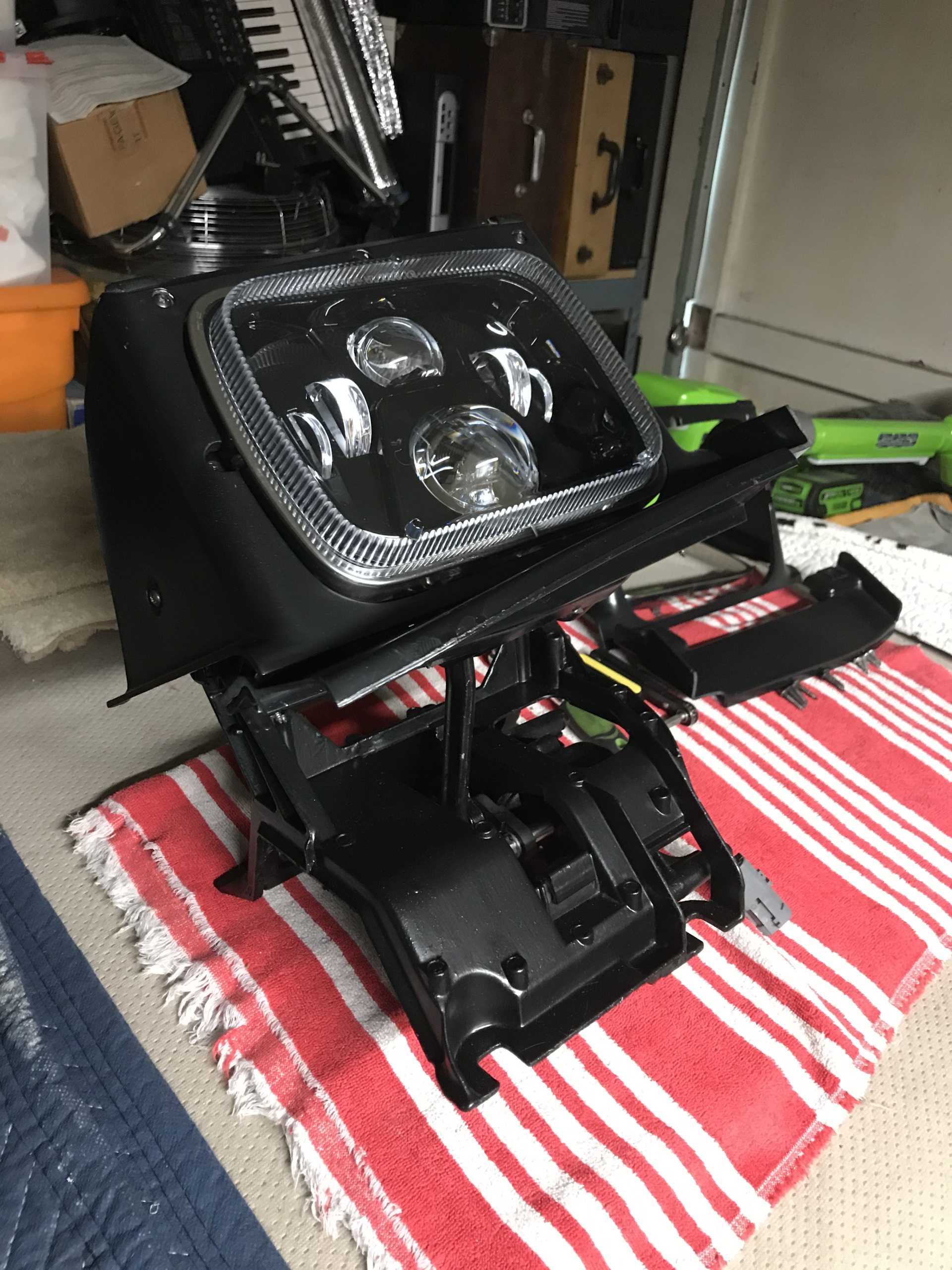

Despite all that’s being said, I love my LED’s on my 85 GT. Had them for a year now and have never had anyone flash their high beams on me, And yes, I carefully aimed them and yes mine are DOT marked. There was one negative: I really had to modify the headlight buckets as the back of the led housings have cooling fins which interfered with the steel buckets. Several hours of moto-tooling and some touch up painting of the buckets black and voila.
Here is a few pics of mine; Kit
