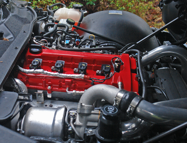

The stock LNF output was actually 260 bhp/ 260 Tq. The factory GMPP kit changed a couple of sensors and the tune and yielded 290 bhp and 340 Tq, a significant boost. There were other after market tunes that gave around 310 bhp and torque similar to the GMPP tune.
If you also change turbos for a higher volume unit, you will increase turbo lag but you will also increase boost pressure. If you optimize some other stuff at the same time, you can head into the high 400s pretty easily.
I run 375 bhp/375 Tq and there are no disadvantages - the lag is almost imperceptible
