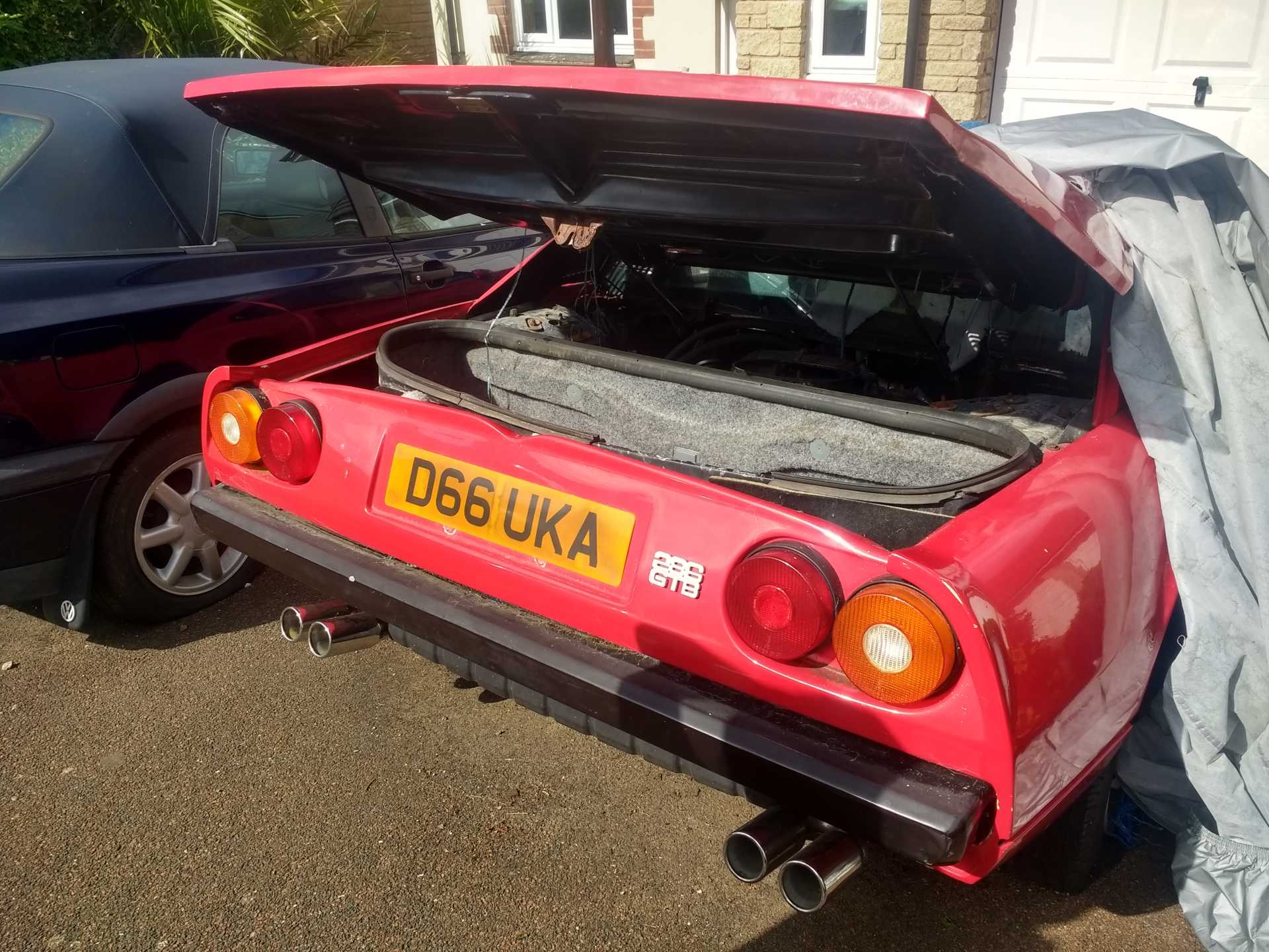

I’ve not had a good look yet as the rear lid only lifts about 24” as the previous owner put ridiculously short struts on it.
It has a small amount of rust on the inner wings but the battery tray seems to be intact! I suppose I’m putting off the inevitable but hopefully it’s not as bad as the video. I’ll keep you posted.
Peter, the decklid doesn't even need to be opened! If you notice in the video, the rear upper frame rails are checked by looking up through the rear wheel wells (with the plastic liners loosened/removed to gain access).
Judging from how bad your front crossmember apparently was, I'm afraid you're liable to be in for quite a rude awakening.
