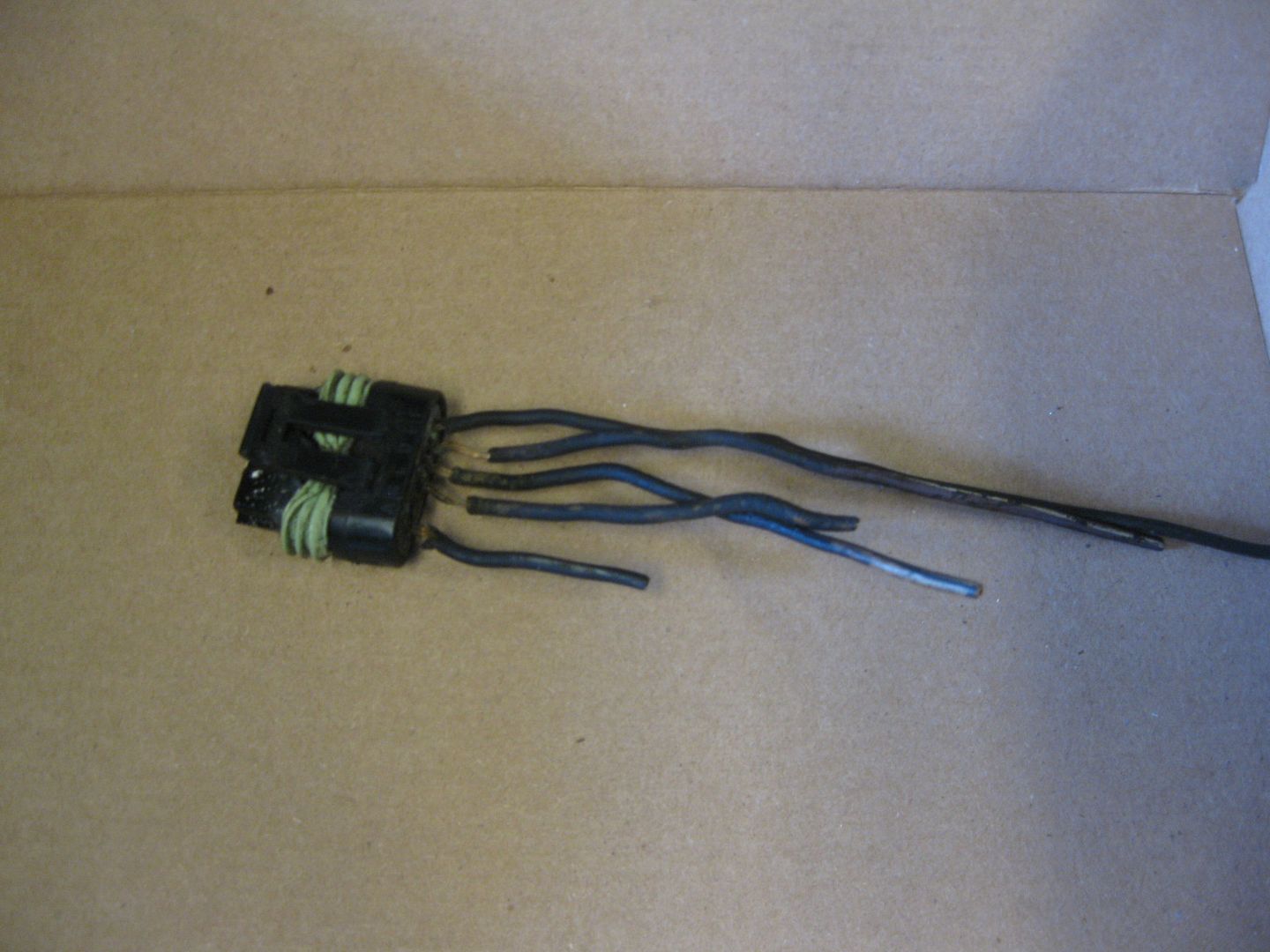

          |   | fieroguru | NOV 09,  04:55 PM |  |
          | Might check the coil pack connector harness end. I was having random loss of power and sometimes a really low idle that would come and go. Eventually it stayed in the low power mode and was able to limp it home.  Never set a code... but this was the culprit:
