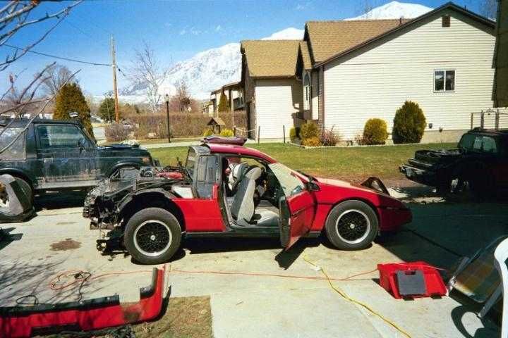

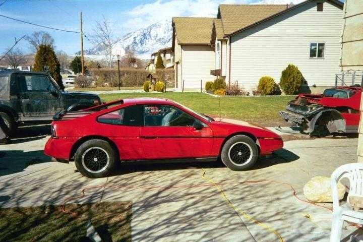

I bought this 88 Coupe in 1999, I'm the second owner.
 This is the only pic I can find of it after all these years as it was born, except for the wheels, spoiler, engine and a few other things. The Holley scoop sold on eBay for $197.50  I wanted a fastback, so...

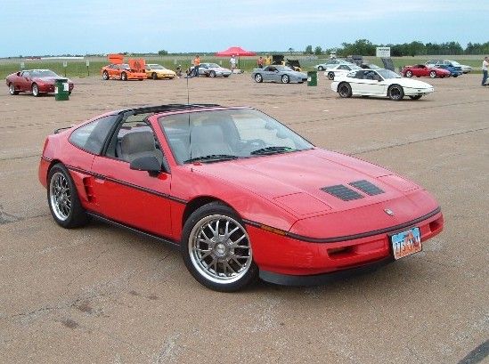

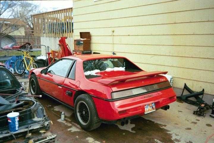

 Then I kept going, adding t-tops, a turbocharger and a few other things. This next pic was taken at Wheatstock in Topeka, Kansas in 2004.

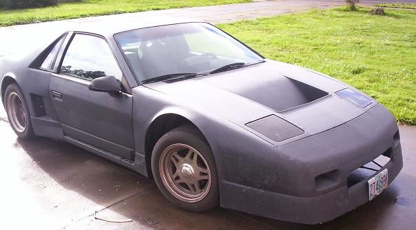

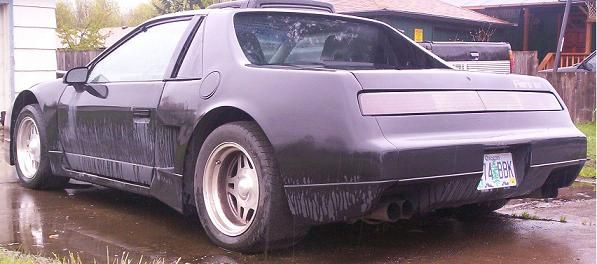

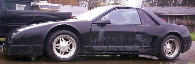

I always liked the IMSA, but not so much the stock ones. They look a bit "odd" to me with the low wheel arches and some other things. Then I find this one listed in The Mall section.
 Yes, I bought it. I moved the body from the 85GT it was on over to my 88 Coupe. I wonder how many go from a notchback to a fastback, then back to a notchback? However, there are some things about it I want to change. I'm lowering the front wheel arches a bit and tweaking the rest. Which is why I am making this thread - I need help!

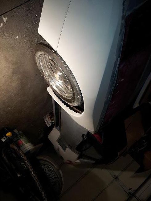

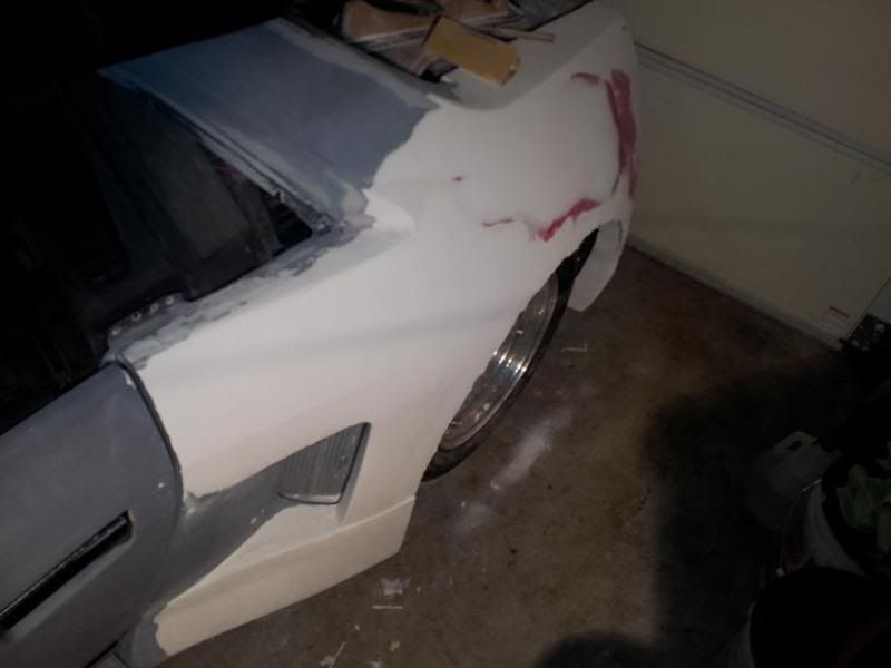

Here it is today:

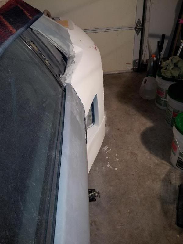

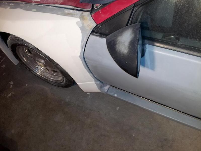

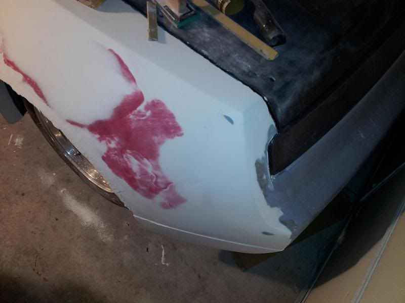

 I lowered the front arches about an inch and a half and widened the front about the same. The rear is wider as well and I shaped the opening differently. In that pic the rear has 10" wide wheels with 0 offset and you can't even see them.
I'm using foam and sheetrock mud to make the changes. I've heard others have done the same with success. Now what I need help with is finishing it properly. Should I make molds if I don't plan to make any copies?

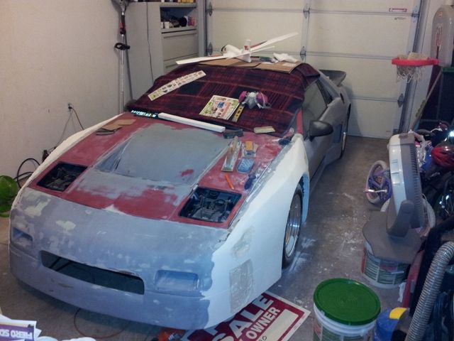

An earlier pic, before I started on the back. That car has become a storage shelf. I have some cleaning and organizing to do in the garage.
I'm gonna need help to finish and maybe some prodding to keep going.[This message has been edited by SCCA FIERO (edited 01-28-2014).]

You lost me here. I thought the black car WAS yours to begin with? Is that the car with those awesome 285/40/15 tires that are no longer made?
SCCA FIERO
JAN 28, 01:20 AM
The black car (IMSA) I bought as you see it in the three pics above. It was an 85GT and built by another member who has since moved on to Corvettes (as far as I know anyway). I moved the IMSA body over to my 88 Coupe, the red car pictured above.
And yes, those tires are no longer made, but Coker makes a 295/40/15 copy of a vintage Michelin tire http://www.summitracing.com.../tire-size/295-40-15 ,but they are expensive. Another option is a 295/50/15 truck-looking tire that looks aweful. My plan is to have wheels made for this car.

Car looks great. It's had quite a journey as have you with it.
To answer your question, at least from my experience, yes, most "pros" will make a mold for the finished parts they plan to use, even if there is no plan for production and it's just going to be a one of.
Some of the reasoning is that when you make the plug, it's kind of "cobbled" together in bits and pieces till you finally get what you want, but it usually weighs a ton and is not very stable as far as vibration and general use. The way you are doing it, not sure if when you are done, you could get all your raw materials out from behind your finished fiberglass panels, but that's gonna have to be your call.
Short answer is yes, even if you don't plan to make any copies. Not a law or even a rule, just an observation based on what I've seen/heard/learned.

I don't plan on leaving the foam and mud on the finished panels. I was thinking the best way to go about it would be to make molds of the parts I am changing, then removing all the foam/mud and glassing the parts to the existing parts. Looks like I will learn to make a mold

Keep in mind, there is usually a difference between a mold made for a "one of" and a "production" mold.
The one of mold does not have to be as thick (fewer layers of reinforcement) and the tooling gel coat on the pulling surface is not an absolute necessity (could just use regular gel coat) but is a better grade (withstands higher temps) of gel coat.
There are plenty of sites with info on how to go about it, but here is one that I generally pass on to those looking to do something like you're contemplating: http://www.fibreglast.com/category/Learning_Center
You could back your mold with foam core or something similar and still not have to use as much reinforcement, but basically end up with a near production quality mold, especially if you spring for the tooling gel to pull from.
Their prices on materials is kinda high, but the info is good. We generally get our supplies at Composite One.
With what you've done thus far, there's no question you'll do great with the finish up part!
On the other hand, if you go about it right, you could do what you were thinking in the first place and not have to make a mold at all, just up to you what you want to end up with. If I'm understanding you right, you planned to build up what you want, skin it with fiberglass, then remove the material/s used to do the build up and leave the new fiberglass shell as your finished surface? No reason that couldn't be made to work, just a matter of what you want to do. Most guys who have done what you are doing, want the new part to look like a new part, inside and out, that's why they make a mold in the first place. See if you can find the thread done by Alex, who I believe was in FL at the time when posted about making his wide body car, which turned out beautifully. He did exactly what you are doing....made the mods he wanted to the body, made molds and pulled the parts to build his car the way he wanted it. Don't remember his exact screen name, but he used the car as part of his entry requirements to get into an engineering/design school, and I think is now employed in the field. I'm sure somebody else on here can chime in and fill in the particulars, it was an impressive project, and turned out well. He made his own molds, not even sure if he even used gel coat in his, but it does make it easier to take parts out of.

Back in the day people gave me a lot of crap for using sheetrock mud for shaping - Used it on my whole front clip (old thread).
You have a couple choices at this point.
Cheap - fiberglass skin it, remove all the buildup underneath and reinforce the underside with more glass... You will end up with a skin aprox 1/8" wider then your 'buck' but if you account for that in plug production then it works out fine.
Quality/Better end result - get the shape exactly how you want it, apply a couple layers of primer, seal it with some cheap spray paint - then proceed to wax and use a PVA release agent. Make your molds - Ideally on a 'one off' you want to make the mold thick enough to pull at least 2 copies (you would want to strangle someone if you got it damaged one day and had to start all over)

Your release agent is going to be key in getting the molds off without pulling your plugs apart.
Duratec makes a good finish to make a mold on. Used to be able to use laquer paint, but you just can't get the "real" stuff anymore, not even sure if anybody still makes it. They sell stuff that's called "laquer", but it's nothing like what it used to be.
You just have to make sure your plugs are sealed good, and end up slick enough that "a fly couldn't land on it" , that's what the guy I learned from always said.
I generally use gel coat to seal-finish off a plug. Yes, you still have to put the hardner in ( a little more than usual) and work fairly quickly, I spray it on with a regular hvlp gun (about 5 coats) thinned with acetone or laquer thinner (50/50) and have never had a problem seperating the mold afterward. Proper prep is the key.
Whatever you end up using, you'll want to fine sand it (usually wet) up to at least #600, and if you want to go all out, all the way up to #1200, but most don't bother and it's not necessary, just depends on how smooth you want your finished part, and how much work you want to do to get it that way after it's out of the mold. Most molds are going to be wet sanded and buffed before they get used, but again, depends on how much work you want to do and when you want to do it.
Then the waxing comes......again, up to what you want to end up with, and how much work you want to do to get there, and if you want to do it now, or later. The more time you spend making your mold the way it should be, the less work you'll have to do to your parts when they come out. Being that you're going for a one of, I wouldn't go overboard on the molds, cause you're only going to have to work one set of parts, one time, but the rule is the same....the more work/time you put into the molds, generally, the better your parts come out. I usually put about 10 coats of wax on a new mold before using it the first time. Not sure you'd have to go to that extreme, but....see above^. Whatever you do for a finish and/or waxing, you'll want to use a seperate release agent like PVA or Fibrelease, to help ensure you don't have trouble getting the mold off your plug.
