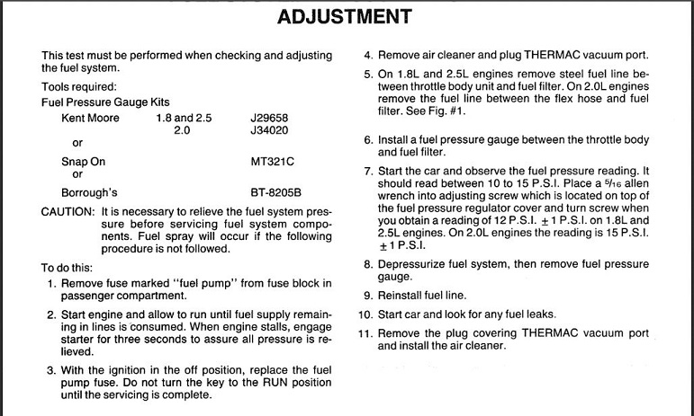

Did you ever get your drivability issues fixed? I have a Holley TBI on my 84 as well. It starts and runs fine but gets horrible gas mileage, around 12 mpg Seems to idle well, has a 195 thermostat in it so I'm assuming it goes into closed loop although I need to verify that with my scan tool. I did adjust the fuel pressure regulator up a bit after I installed the Holley. Not sure how to adjust the regulator without using an exhaust gas analyzer Here are the tuning instructions from the Holley install doc:
