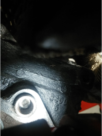

mitchjl22
JUN 10, 03:01 PM
Yes. All 3800s use the FWD bellhousing
.jpg)
-Mitch
