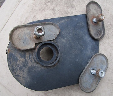

sourmash
OCT 29, 05:03 PM
Well, so much for that memory. I just walked out in the garage to look at the springs and this was right beside them.

arbakken
MAY 10, 06:08 PM
Anyone happen to snag a few measurements from a set of these plates? If anyone can get a napkin sketch together I would be more than happy to make drawings/templates/waterjet/laser files.
