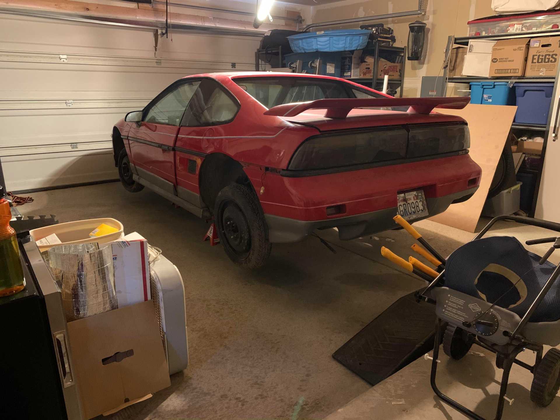

Whats up everyone, Sorry for the neglect here but Im starting up a new project now with a tentative 5 year goal for completion, though with how motivated my oldest son is I might be finishing this a head of schedule. lol Huge shoutout to Alex and Adam from LightspeedFieros for hooking me up with this car!
Timeline for the Project in years.
- Strip to bare Chassis.
- Frame modifications, Engine/Tranny setup and Wire management.
- Suspension modifications.
- Start body modifications.
- Finish body mods and Final painting!

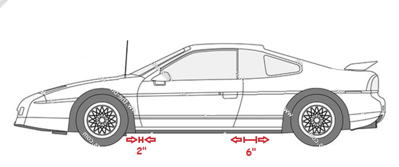

The plan is to take, in this case, an '86 GT, and modernize it inside and out with Ford parts and a 3.5L Eco Boost with the 6 speed Manumatic from a '18+ Ford Flex. Why Ford some may ask? Well, I don't particularly care for GM/Chevy parts and like Ford better. Everything Im wanting to do as far as the electrical modernization and engine/tranny swap sound extremely hard, but I plan to simplify it by reusing as much from a ford donor as possible, to include the body harness to keep everything simple. I have no issues with electrical work either as this will be as simple as lengthening or shortening sections of the old harness to fit in the fiero.
As far as the Body goes I will be stretching the engine bay to fit the DOHC 3.5l v6 but as to how much I am unsure of right now, but I don't plan to exceed a 6in stretch. Hopefully just a 2-4in stretch will be all that's needed. As well, I am wanting to move the front suspension back 2in max, but this is idea is not set in stone yet due to the complexity. Click to show

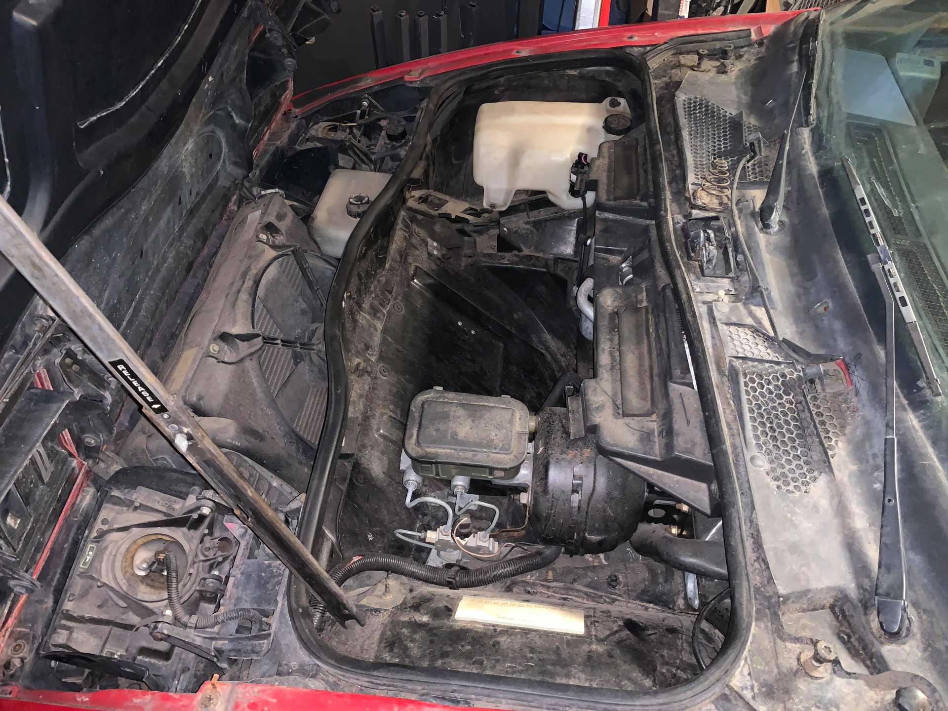

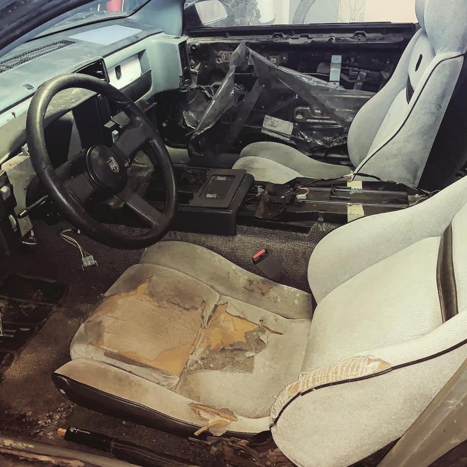

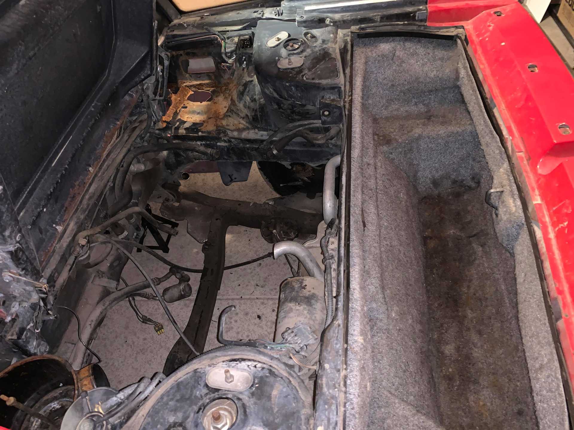

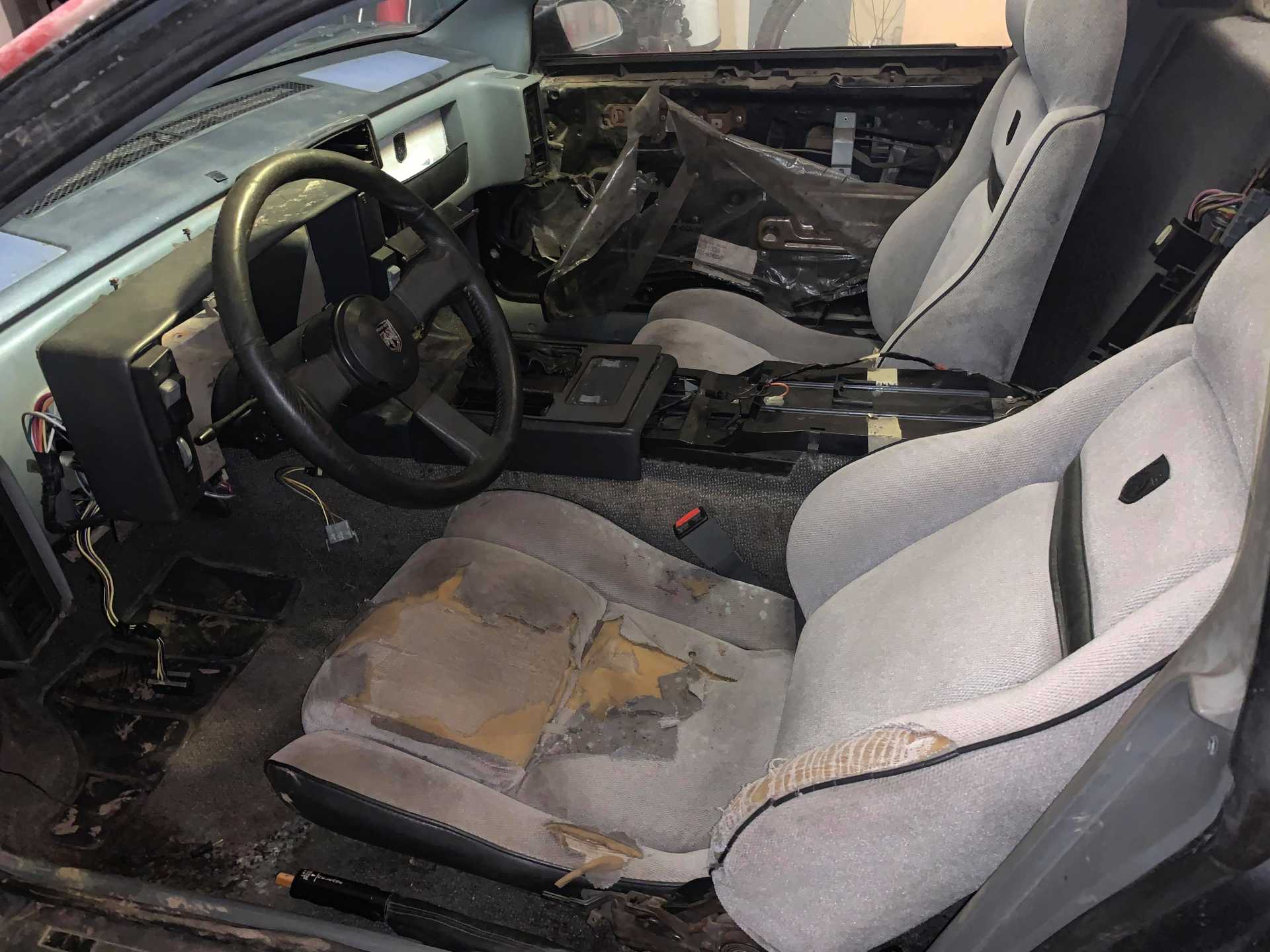

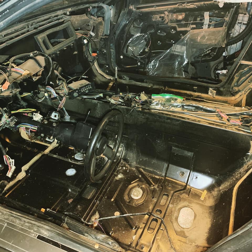

Started tearing apart the Interior today and called it quites for the day after we got the dash, trim and carpet out...Any suggestions on how to remove the Steering Column?

I like the 1-2 chop. I think the original roof line is to high. But why the engine bay and front suspension? Isn't the Flex a front wheel drive? Why move the front suspension back? If I were to move it, I would go forward an inch or so. This would give me more leg room.
Halcyon25
MAR 21, 10:04 AM
I like the 1-2 chop. I think the original roof line is to high. But why the engine bay and front suspension? Isn't the Flex a front wheel drive? Why move the front suspension back? If I were to move it, I would go forward an inch or so. This would give me more leg room. |
Agreed, always felt it seemed high as well and didn't think a short chop would detract from the original look much.
Engine bay stretch is to make room for the dohc 3.5l twin turbo'ed v6... Moving the front rearward though mostly has to do with personal preference, I don't like how far forward everything is and want to move them rearward to reflect the more exotic apperances. Also, Im 5'9" and in my previous 86 SE I had a lot of trouble finding a spot for the seat were I was comfortable with. Either the pedals were perfect but the wheel was in my chest (or it felt like at least), or the wheel was perfect and I had to reach for the pedals and I hated life... Love the car, just trying to make it more comfortable. I am also not worried about loosing the 2 inches as many of my taller 6+ft friends had more than enough leg room.
