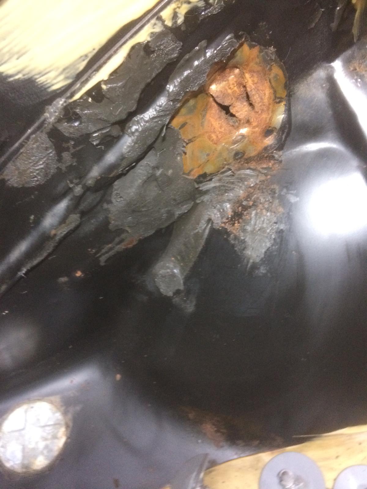

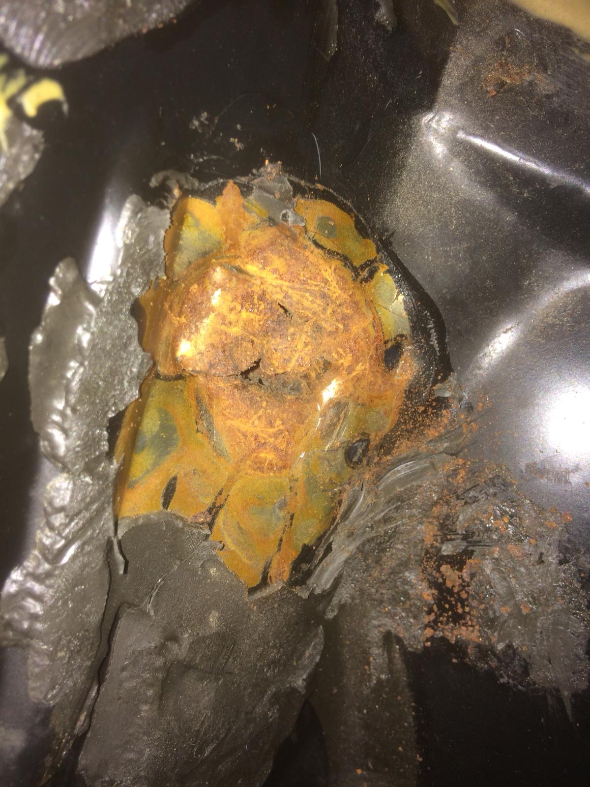

Hello PFF'ers
I decided after 20+ years ownership it was time to peer under the boot carpet.
No problems found other than a very odd section. It's on the near side and has spot welds around it. It was covered in black bitumen type goo. There is a hole in the centre bit no particular rust. The rest of the boot is lovely.
And now for a pic or two...
Car is a 1986 V6 SE.
Any idea what this is aboot?[This message has been edited by PK (edited 06-22-2020).]

Pull the inner fender plastic to likely find more rust. Some areas have plastic "screws" that are really "rivets." Might "unscrew" but many won't and need carefully prying them out then the rivet body pops out. reinstall put body in then "screw" in.
"Black goo" can be used by GM to protect a part but is often used by many to hind rust problems.
Rust on frame parts beyond surface rust can clean/treat easy is often a "death sentence" to many cars. Some claim can "fix" but not really and worse the "fix" can cause big failures in a wreck because changes how crush zones work.
The Ogre's Fiero Cave[This message has been edited by theogre (edited 06-22-2020).]

No rust at all on inner Ogre that has all been apart and look absolutely fine. The other side of boot is beautiful. All the bits around this weirdness are beautiful...its just this one bit, it isn't rusty, the hole looks like it was made by something other than rust
Not having access to any other Fiero boots to prod, I didn't know of this was where something used to be housed....or what. Very odd. Will have another dig at it tomorrow.

If the frame-rails are O.K., I'd say there was a once a leak in the gasket around the boot. An '86 SE that I had this problem and it used to collect water when I left it parked in the weather or after I washed it. The water used to collect in this area and I developed surface rust in the same area. From the pictures, it looks like a previous owner had a similar problem and fixed it by cutting out the damaged area and spot welding a patch in.

The patch would have had to be when it was just a baby as I have had it for erm 23years. And if it is a patch it somehow managed to get a gougey hole on the middle! Having looked at trunk rot pics this is in the right place!
Maybe inside leak Mike. The frame rail is definitely solid, all wheel wells etc came off late last year and everything inspected and cleaned underneath.
