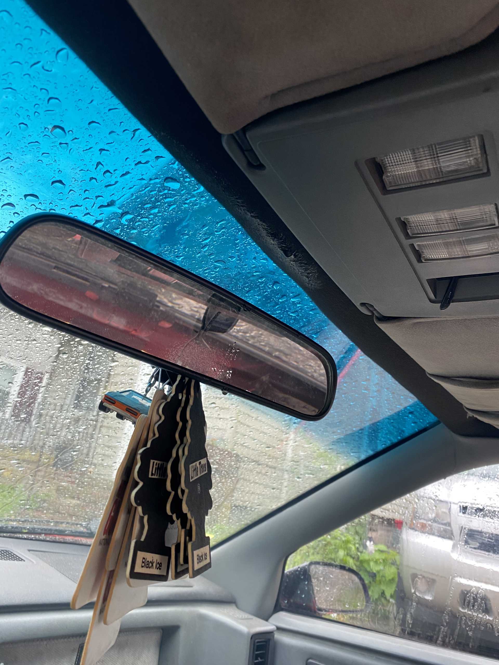

So I got a horrible leak no where near the sunroof it’s from the front ? Headliner is soaked and water drips right in the middle of the center console do I need to get the windshield resealed ?🤦♂️

Originally posted by pontiacfierokid1985: So I got a horrible leak no where near the sunroof it’s from the front ? Headliner is soaked and water drips right in the middle of the center console do I need to get the windshield repealed ? 🤦♂️
Perhaps you could start by ensuring it isn’t the sunroof, as that could be the more likely cause if you don’t see any visible signs of damage to the windshield from the outside. Seal off the windshield and give the sunroof area a nice soapy bath and monitor for the issue reoccurring.
