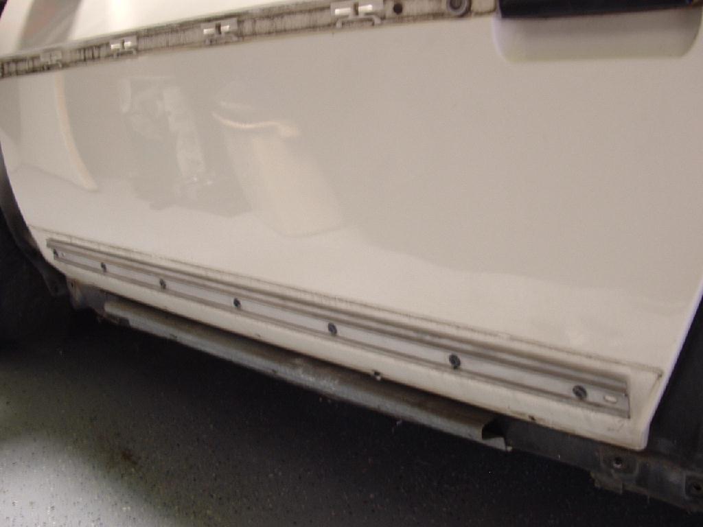

IMSA GT
AUG 27, 07:16 PM
This is what is inside the sill as mentioned above.
imacflier
AUG 27, 09:43 PM
IMSA GT,
WOW! What a great and helpful pic!
Thank you so very much!

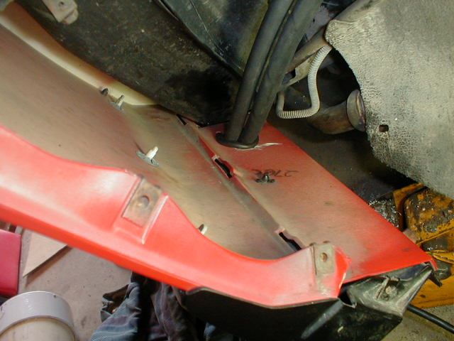

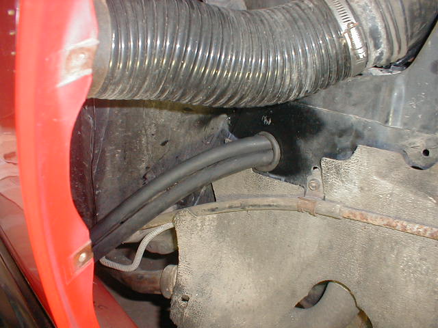

Spoon
SEP 03, 09:13 PM
| quote | Originally posted by imacflier:
Spoon,
Just where did you drill to make entry and exit from the ground effects?
TIA,
Larry |
Here's the entry point. The exit is at and behind the front wheel liner. leads right to the connectors on the rack. Can't find pic.
