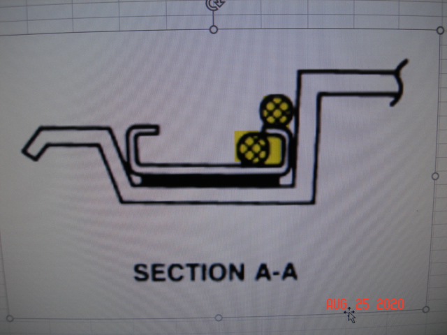

             Okay, I did this before on a previous Fiero, and got excess adhesive on myself and the car.  I have not found any good instructions or videos on replacing the weatherstrip.
  Is the adhesive applied to the tracks and car body opening before installing the rubber into the tracks?  I believe I previously glued the rubber to the tracks, then tried to apply adhesive between the car body and the weatherstrip.  The Fiero Store section-drawing A-A shows adhesive applied to the middle of the track, and along the top/outer edge of the track.  If adhesive is applied first, are you still able to push the rubber into the tracks?  I guess I am asking for a sequence of installation.  Am I making this too difficult?

            Coincidence for me that this should come up.  I just bought new weatherstrip for the sunroof on my 88 GT, planning on replacing it when I paint the roof (clear coat is pretty chalky).
  My factory manual says something on the matter, but not much.  There's a not real informative Figure 14, but maybe with the text it's enough to answer the question --
  VENT GLASS WEATHERSTRIP Install or Connect 1. Adhesive to gutter (40)  2. Adhesive to weatherstrip (35) 3. Allow adhesive to become tacky before installing weatherstrip. 4 Apply a bead of adhesive between outboard periphery of weatherstrip and body opening (41) to prevent water seepage.  Do not plug drain holes. 5 Watertest with a soft spray of warm or hot water.

  Several years back, in prep for painting my car, I bought a new gasket from Pontiac and I tore out the old one.  I spent hours and hours cleaning out all of the old adhesive from the tracks, then once the paint was finished, I applied new black 3M weatherstrip adhesive exactly how the factory manual shows to do so.  I also enlarged the drain holes per the TSB.  No matter what I did, I could never get the rear portion of the glass to pull tight against the seal.  I eventually gave-up and bought a used gasket from a wrecking yard.  Cleaned out all of the old (new) adhesive and installed the used gasket.  I get a lot of wind noise at higher speeds, but no water leaks.

            The front and rear of the weatherstrip are shaped differently.  Aftermarket seals I've seen aren't marked in any way to indicate which is which.  I found that the front should stand up a bit in front of the glass, between the body and glass so that the front edge of the glass nestles against the seal when the sunroof is closed.  The rear edge sits a bit lower.  The first one I installed backward and it whistled and leaked.  Even let the rain come in at the front while driving.  Once I reversed it, the problems went away and I never used any form of adhesive.
