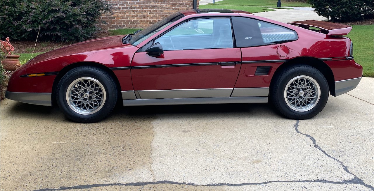

As one of the unfortunates who grew up with no mechanical knowledge but a passion for cars since I was 16 I need some advice from the Fiero Faithful. I recently got back into a Fiero after 35 years. As an old fart with no mechanical aptitude but some discretionary income I need to get some things done on my '87 GT. I reached out to a highly recommended hot rod shop in my area that does cars/trucks seen at SEMA. (Think FantomWorks on Motortrend but smaller )
Anyway- I went and met the owner and gave him my wish list of things that need to be done and he sent me a labor cost estimate for each service. I'm supplying most of the parts from the Fiero Store. I would GREATLY appreciate those with knowledge to take a look and give me their opinion. Just want to see if those in the know think these labor costs are in line. (PLEASE UNDERSTAND THIS IS A RETAIL SHOP SO I EXPECT TO PAY RETAIL PRICES AND THESE ARE ESTIMATES) Prep and paint front and rear bumpers (they've got scuffs/nicks/etc)- $800 (the previous owner had them resprayed at one time, very poorly...not a good match. He says he can match) Touch up other areas of paint on body- $38.00 Oil Pan and Valve Cover gaskets- $110 Replace engine mounts- $75 Rebuild front and rear suspensions- bushings/ball joints/tie rods- $600 (the suspension is 33 years old and just feels tired and worn out) Replace rear main seal- $750 Put in Clutch kit while doing rear main seal- $75 Alignment at local shop he uses- $100
Thank you ALL for taking the time to read this and offer your constructive advice. I look forward to seeing the comments.

You have a good looking car there.. The truck is cool too. This prices seem really low for where I am in Ca

Edit - That's a freaking beautiful '87.[This message has been edited by Raydar (edited 08-28-2020).]
