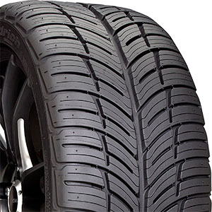

Well, all I can say is a couple months ago I put on a brand new set of 225/50-16 BFG G-Force Comp 2's, and they are easily the most impressive street tires I've ever had on a car. I can hardly believe the tremendous grip these tire have in real-world conditions, which is exactly what I was hoping. I specifically looked for a high-performance tire with a directional tread that would readily shed water and reduce the potential for hydroplaning in a light car with wide tires. Their price is a little higher than you were hoping, but they are still not expensive. W Speed rating (ie up to 168 mph). https://www.discounttire.co...104ca5f699d015e912d4

He's looking for 15" tyres. The BFG G Force doesn't come less than 16".
You are going to be limited finding "good" griping tyres for 15" rims unless you go competition/semi-slicks like Toyo or Yokohama.

Yeah, unfortunately I only saw those G Comps in 16", which is a shame because I like the sound of them. Another big problem I'm facing is finding a decent matching set of tires with the two different sizes. I can find a set that seems decent in 205s, and in 215s, but not both.
