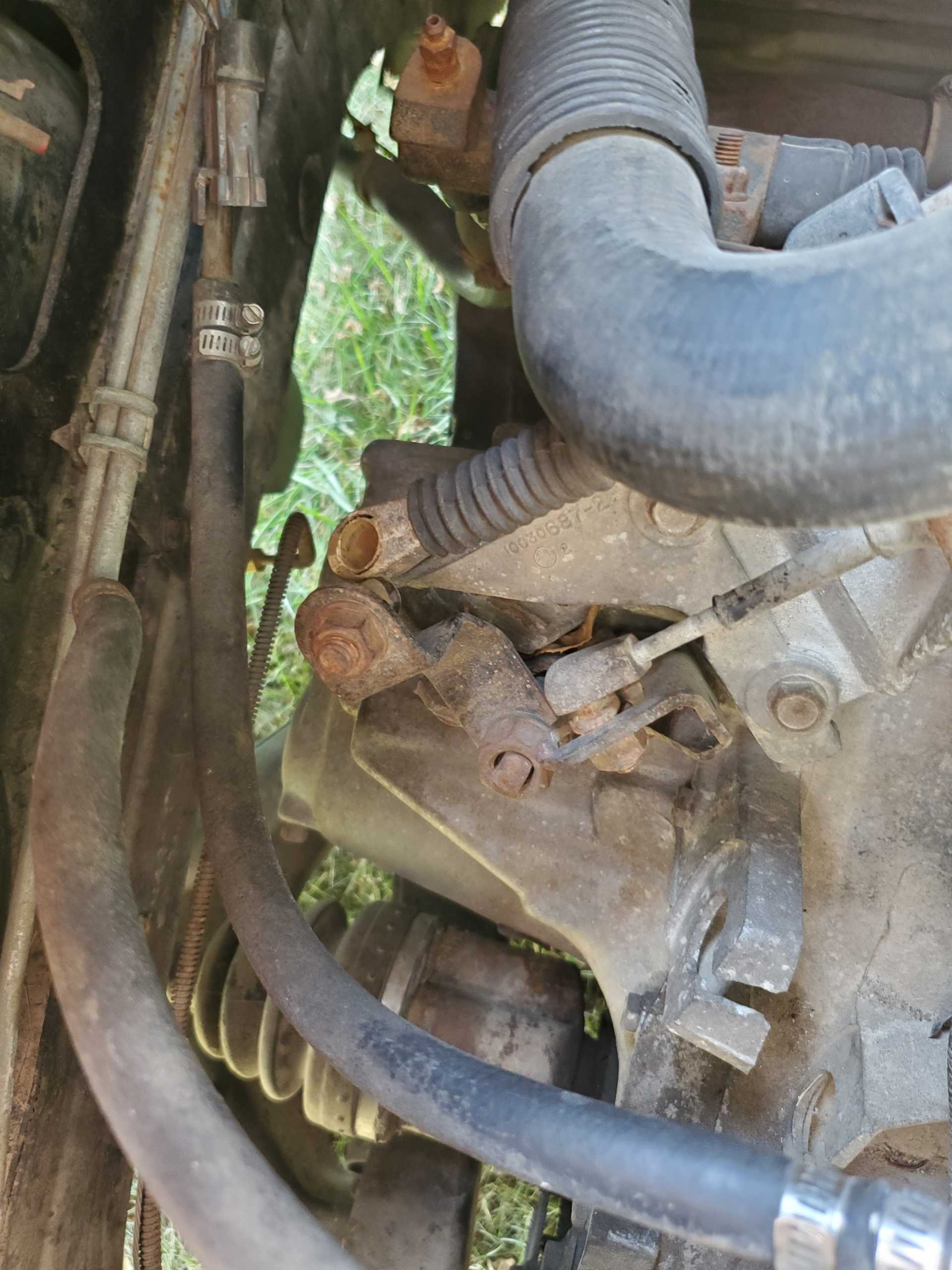

i just check it, and the connection point just under the slave cylinder popped off. I snapped it back on, and i'm back in business. Now i feel like an idiot for driving three blocks in reverse. Is there a pin or something that is supposed to hold it on there?
AUG 27, 03:03 PM
Well, nothing is supposed to be able to just pop off, so I suspect something's missing. Post a picture of what you're referring to.

This is that part, after looking a bit closer, it feels very loose.
AUG 27, 03:47 PM
I've never had this problem myself... but have a look Here for a possible option.
