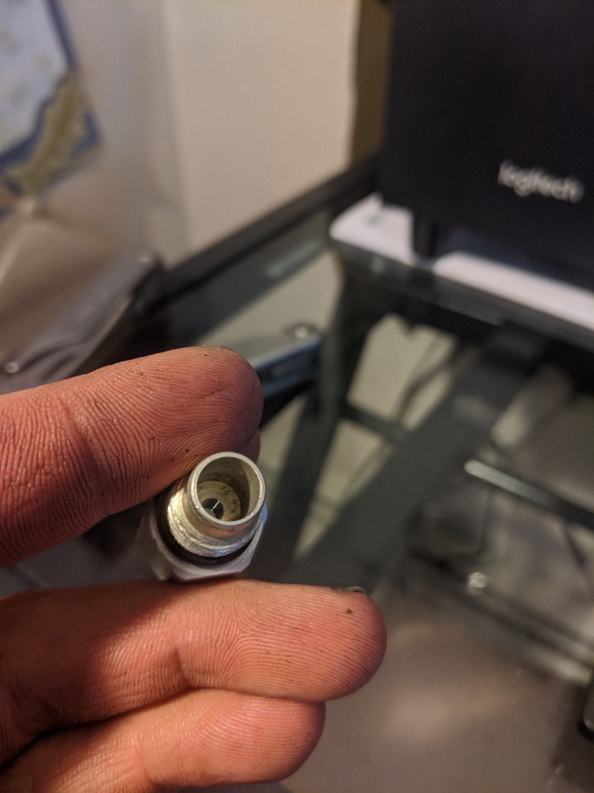

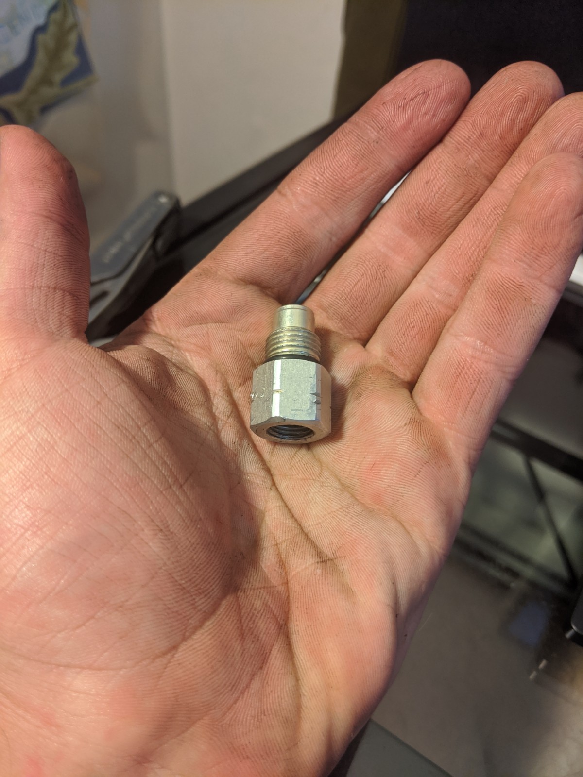

I purchased a set of the stainless steel lines for my 84 SE and after about 6 hours of fighting rusty fittings I have the new ones mostly in place, however I ran into an issue. On the front left line it is the smaller thread size (maybe 3/16"?) however the female end on the 5-way brass fitting that's immediately off the brake master cylinder is larger (maybe 1/4"?). On the this end there is some adapter from the smaller thread size to the larger thread size, however I think the threads on the adapter on the 3/16" size are messed up since the new fitting from the front left line isn't threading in correctly. It looks very similar to https://www.pepboys.com/dor...arded/product/894166 or https://www.amazon.com/Dorm...66-4631-94d3-61b87b5 2511b&pf_rd_r=8AGAVW7TZFQNWJPRDCPP&psc=1&refRID=8AGAVW7TZFQNWJPRDCPP. The adapter itself seems to be either aluminum or zinc if it helps at all.
My question is if this is something factory or if anyone else has run into this, and if something like those two links may work.

These are pictures of the fitting for reference.
AUG 28, 11:37 PM
Looks like Is part of the Combination Valve in my Cave. Is "nut" for balance spool. Most 84 uses different one but not sure if that part is different then other versions.
If wreck have to get whole combi valve for 84 Fiero and likely Very Hard to impossible even from GM.

Sanhino
AUG 29, 10:23 AM
Yes you're absolutely right that's what it's part of. Maybe I can either make it work or find one on eBay.
