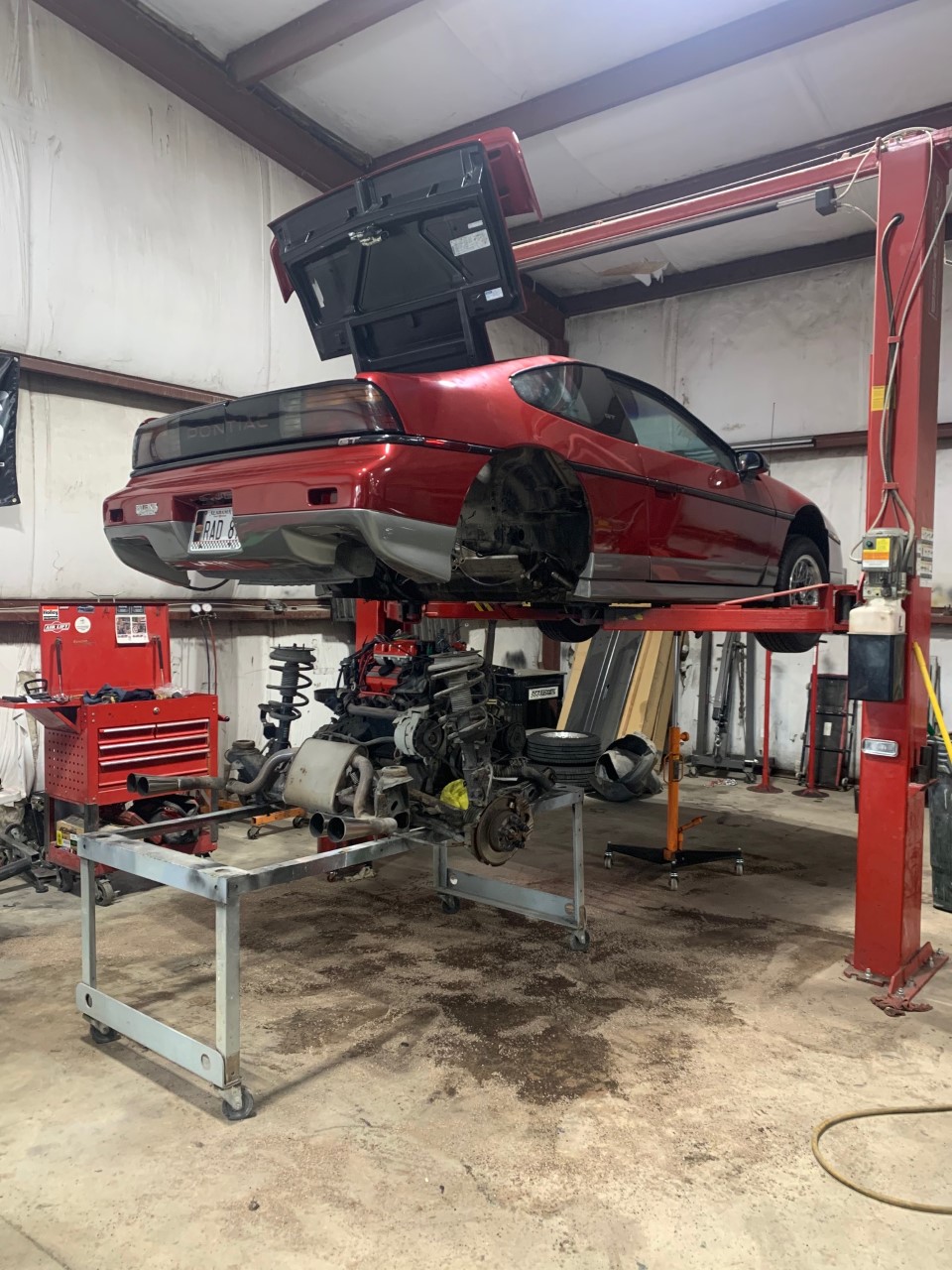

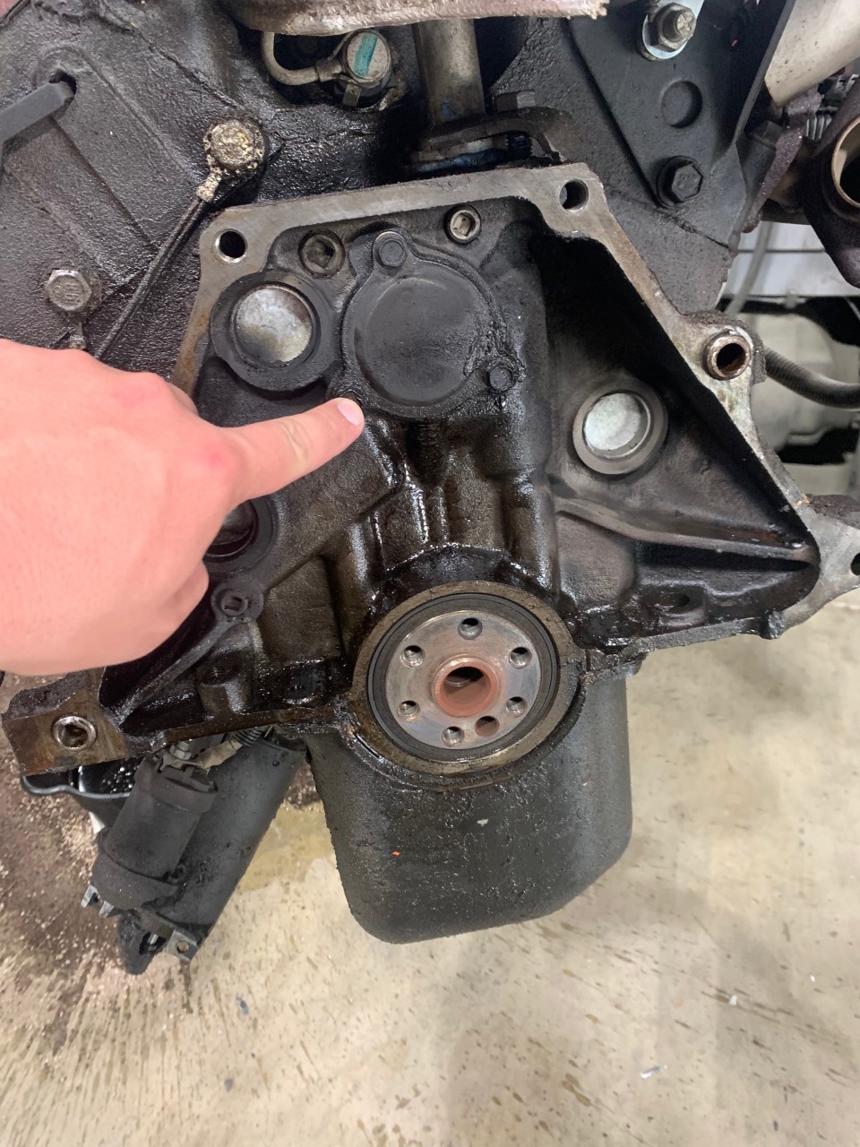

The cradle is now lowered for the first time since she was put together in 1987...cam seal replacement, new clutch kit, oil pan gasket, valve cover gasket...maybe delete the Cat? Then refurbish the suspension...coming along nicely.
ltlfrari
SEP 01, 03:35 PM
Now THAT's a workshop! ------------------ Anything I might say is probably worth what you paid for it, so treat it accordingly!

Notorio
SEP 04, 07:33 PM
| quote | Originally posted by ltlfrari:
I'll second that remark! Methinks you might have a few other leaks as well ...
Spadesluck
SEP 10, 11:40 AM
Valve cover gaskets and possibly head gaskets from the looks of it. Lot of grim there, which is normal for a 30+ year old car.
Will
SEP 10, 01:59 PM
| quote | Originally posted by Spadesluck:
possibly head gaskets from the looks of it. |
Distributor O-ring much more likely.
