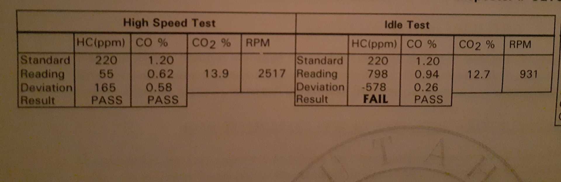

As you can see the only thing that failed was hydrocarbons at idle.
I'm trying get a tune from Sinister Performance, but having a hard time logging data (WinALDL w/USB, which the cable supplier said shouldn't present any problems, but all it will log is raw data that looks totally inaccurate anyway). How do these numbers compare with what you guys have found? Bear in mind, this was on a semi-built 3.4, but I'm interested to hear.

This is a typical 2 speed test w/ sniffer in tail pipe.
Many GM cars barely pass at Idle. I bet you'll find BLM is pegged at idle. Only reason not tripping MIL light is because Integrator and maybe other sensors doesn't pegged long enough to set a DTC. See my Cave, Scan Tool Help
Numbers above are often Worse if have no or cold cat or cat w/ problems because part of 2 step test is trying to find a dead/no cat car. Even when you run the car on the highway then idle for a long time or shut down for just a minute or three, the cat can be too cold to work at test time. This is why some inspection places have big signs to "park and run car a fast idle" (paraphrase) to avoid E-test fails.
Note that most testers have an ignition "pickup" to read RPM. Many inspectors put this on the front of Fiero and make it hard to test. I get this every time I go and have hard time to pass because pickup fails. This will fail too but not failing for counting numbers.
Likely issues causing Fail... Engine has problems. quick examples If has HEI has can have problem w/ base timing, iffy FI, iffy Fuel Pressure, has no/cold cat or all. WinALDL and others scanning ECM often lies to you when you're trying "engine tuning" because OBD1 and early OBD2 ECM in "Scan Mode" isn't fast enough to read many sensors in "real time." GM et al Never tunes a motor based only on ALDL data stream because of this. Most manufacturers won't tune using this at all and programing is done w/ engine dyno data and a lot more expensive tools.------------------ Dr. Ian Malcolm: Yeah, but your scientists were so preoccupied with whether or not they could, they didn't stop to think if they should. (Jurassic Park)

That's really interesting! I did find out this morning that its throwing the IAC and TPS codes, but I haven't done any testing to see if they are functioning properly. It's odd because it idles smoothly and has great power, just a bit rich at idle. I'm hoping that I can get it solved between those two potential issues and then just dyno it to make sure my AFR is in a comfortable spot.

quote | Originally posted by pmbrunelle: Does the idle RPM have to be within some certain limits to pass the test? |
Yes. Both speeds must be w/in a narrow window of RPM or instant Fail. Exact range for each step is up to state rules. This test method is still use by several states for anyone driving OBD1 and older as a daily ride.
Higher idle Won't fix the problem because reading is 3+ times the limit. Only when you fail a numbers like 220 limit but reads ~ 225, bumping the to just under idle speed limit might pass.
Running E85 may Fail too. Ethanol adds O2 same as MTBE did and now "banned" in many places. If added O2 from E85 or car w/ exhaust problems then Sniffier can/will "see" and "trip" error (Often called "Exhaust Dilution" error) and you Fail. If Inspectors think you "cheated" w/ that error then can cause a lot more expensive legal problems than just fail your car.
