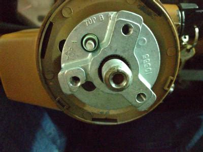

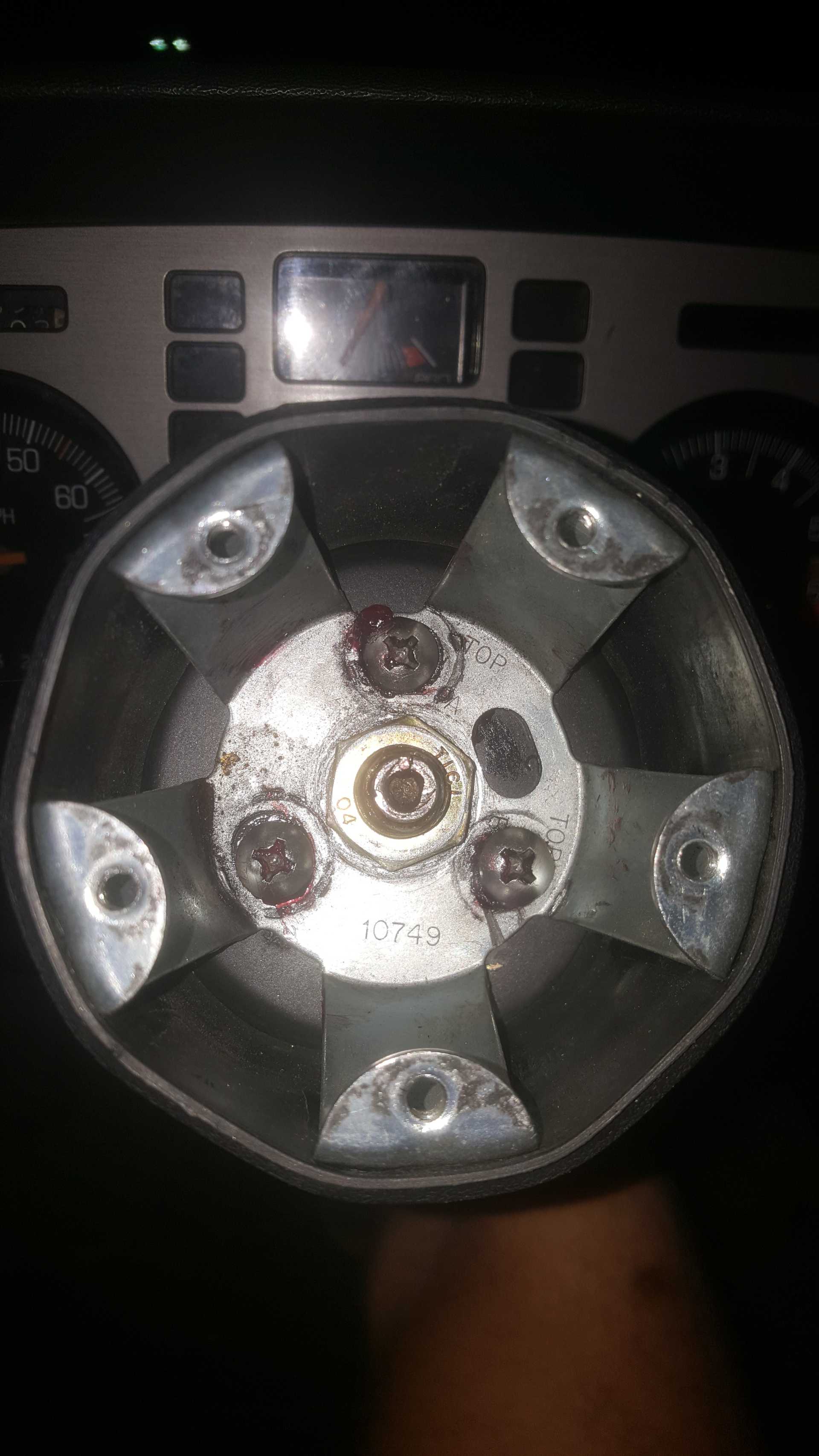

Monkeybean007
SEP 06, 04:32 PM
 Here's the Pic I could get

From the picture it looks like you're not using a Fiero steering wheel, or any GM wheel. Looks like a Grant steering wheel adapter, or similar. But the adapter behind the part visible in the photo should engage the splines, and then the three screws should tie the wheel to the adapter should keep it from spinning unless the adapter backs completely off the splines. I'm talking about this piece:
I wonder if the adapter behind what's visible here has damaged splines - I've used Grant wheels before (not on a Fiero), and they work well, but the adapter is much softer than the GM steering column shaft. It's possible the splines in this piece are damaged/stripped if it was not pressed on sufficiently to fully engage the splines the first time. Also, the manual steering of the Fiero at low speed puts more stress on this part.
To fix the problem, I suggest replacing the adapter kit to get a replacement for this part, make sure it is fully engaged with the shaft - maybe put a bit of blue Loctite on the splines (this might make later removal difficult, however) - reassemble, and torque the nut down. Definitely put Loctite on the threads there, and get a replacement for the clip Ogre mentioned and install it. Unless the adapter is just too soft for the Fiero's manual steering (doubtful), you should be fine.

I agree with the above post. That is a Grant adapter and the plate has "teeth" that grab on to the splines of the factory column. If they are stripped out not aligned, it becomes deadly. [This message has been edited by IMSA GT (edited 09-07-2020).]
