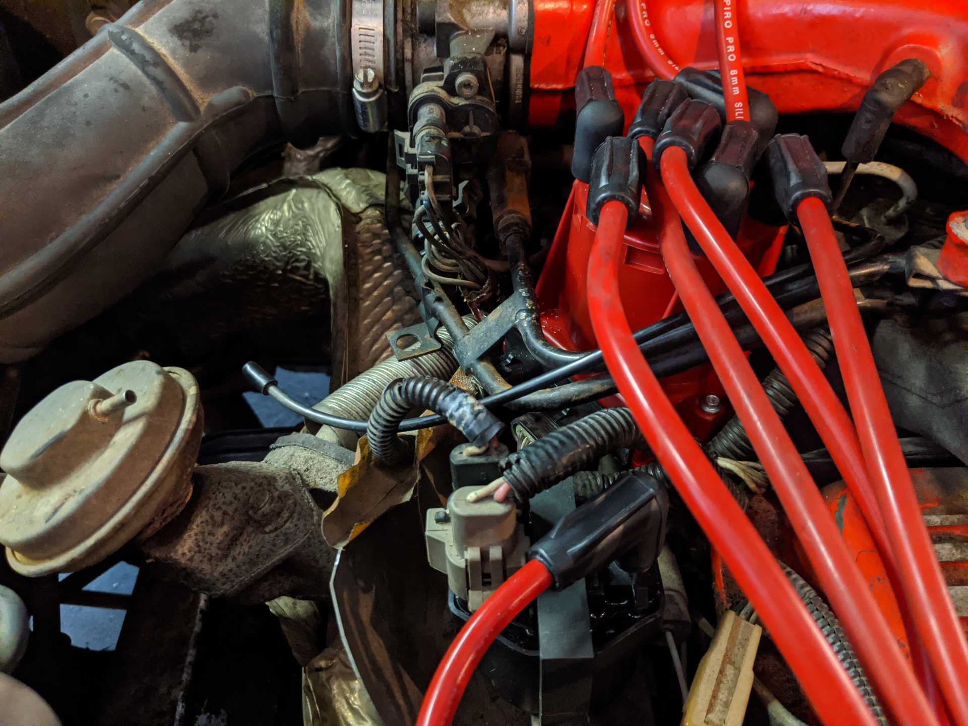

Unfortunately the EGR Valve isn't hooked up, there was this pencil thin hard plastic line next to it, which I suspected was the vacuum for it. I have already plugged this particular line with no luck. Is this the correct line?------------------ - Darryl
Why would you cap it off instead of connecting it to the EGR valve? The EGR pipe that often cracks and leaks is the one in your picture with the silver "jacket" on it.
