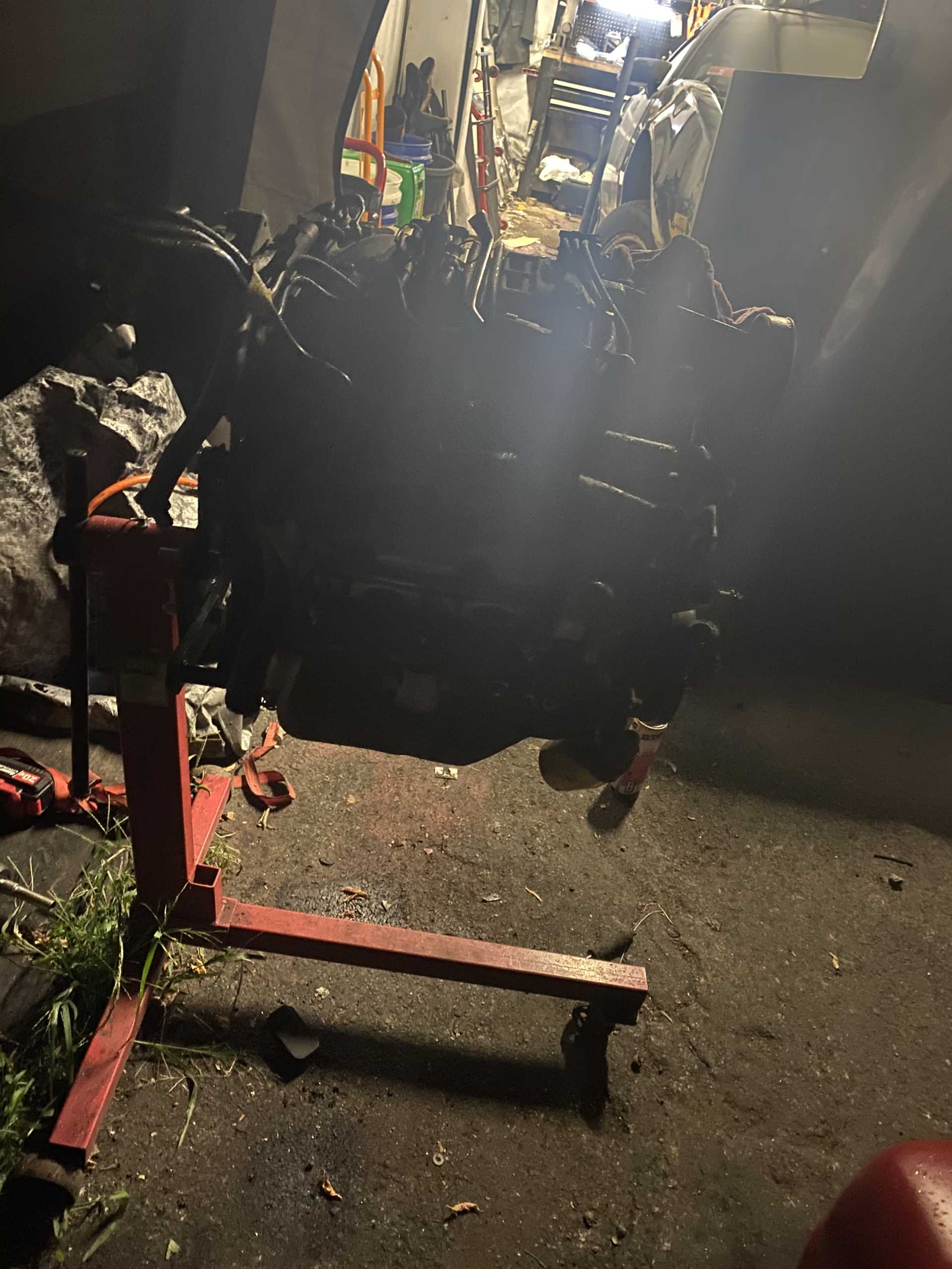

I’m doing a 3800sc swap in my 86gt after a rod bearing let go on me last week is this the correct oil filter adaptor.
It kinda angles off towards the crank I thought this one will hit the cradle when the filter is on

got mine off of a buick lasabre it points to th harmonic balancer, the west coast fiiero store wants 100.00, I paid five bucks

SEP 13, 11:39 AM
Ok so will a n/a one work fine or does it have to be off a supercharged car? I take it 3800 blocks are all the same correct like small block etc
