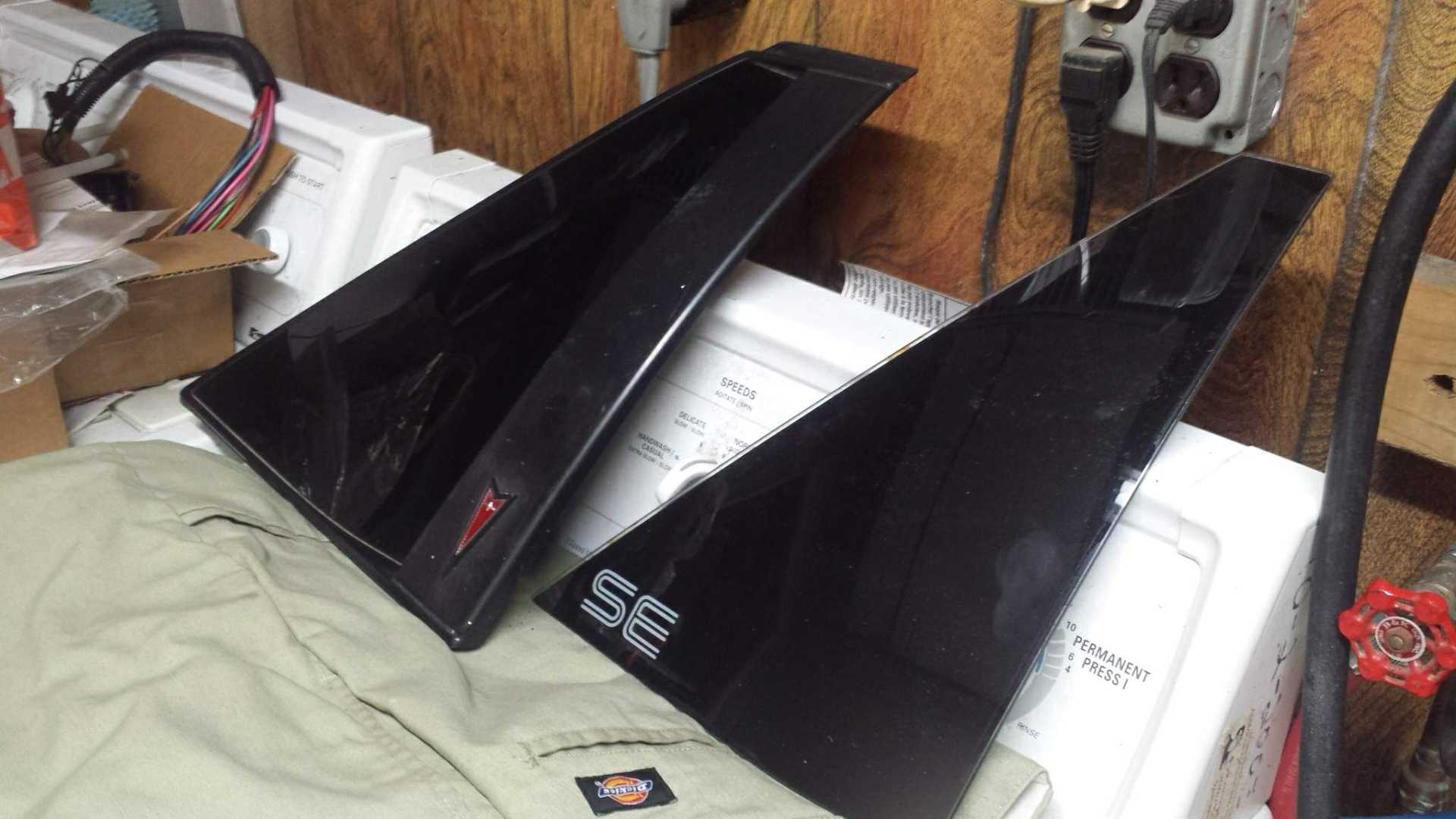

I know I have a 1/4 glass. Perhaps right & left. One is out of frame and the other is with frame. See if I can find pic.
Here we go. Lots of reflection but they're pretty good. I can take better pic if interested. Appears both are passenger side.
