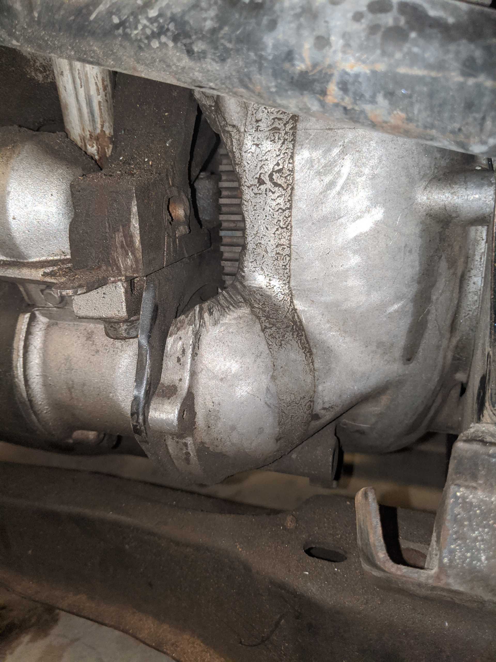

Stricken
SEP 24, 09:56 PM
Um, well... There's this...
