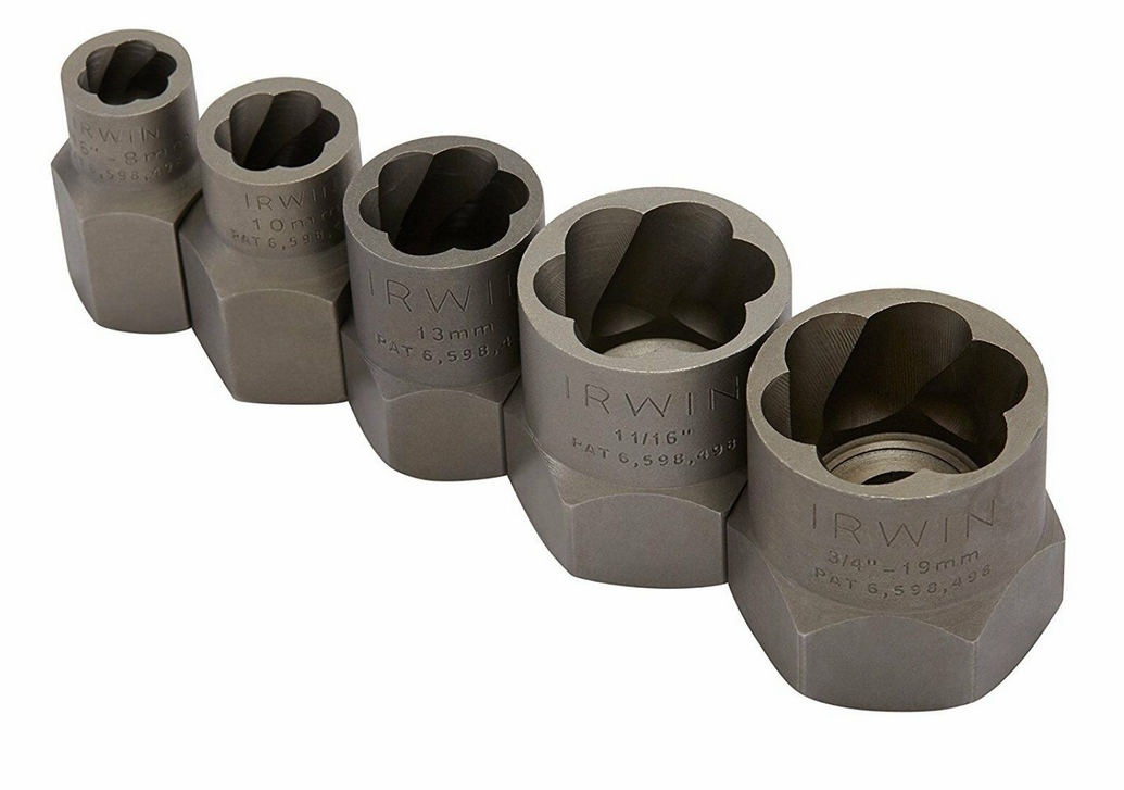

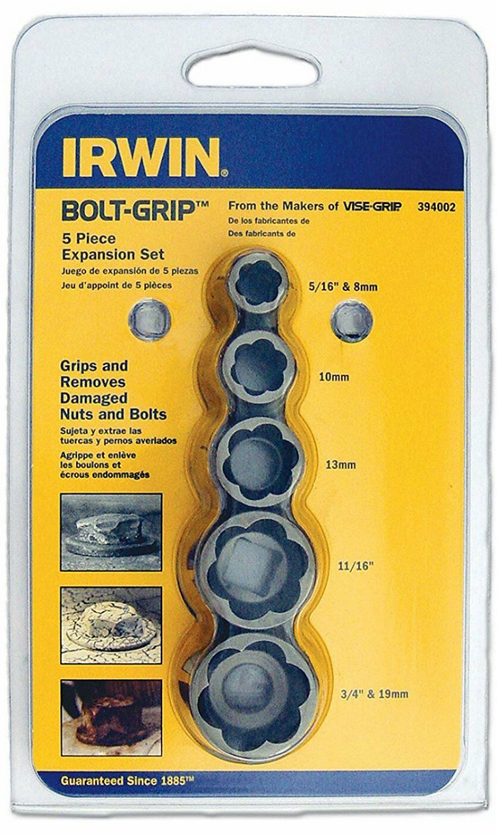

I ordered a nut extractor set:
Will try that first.

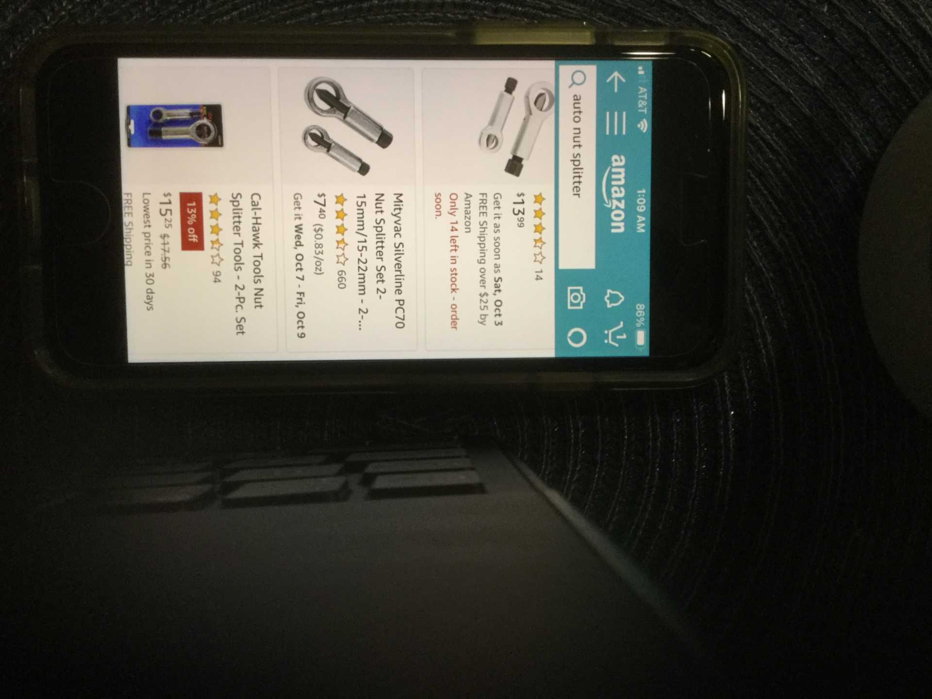

There is a device called a nut splitter. I found some on Amazon $ 7 to $ 15, plus shipping. I would imagine auto or tool suppliers in your country sell them

There is a device called a nut splitter. I found some on Amazon $ 7 to $ 15, plus shipping. I would imagine auto or tool suppliers in your country sell them |
Yes, that would work if there was actually space for them. But since the lug nuts are recessed in the rims, there isn't...
