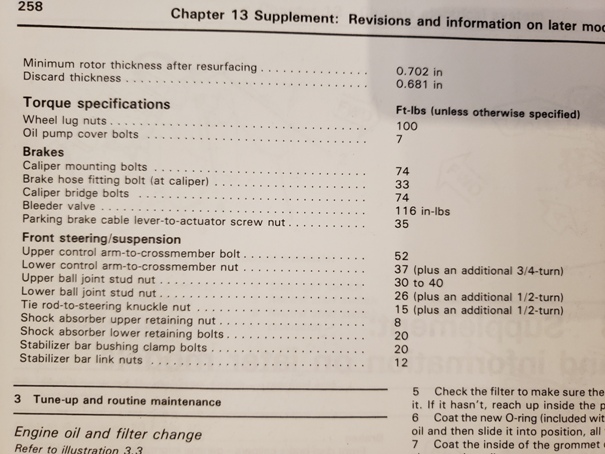

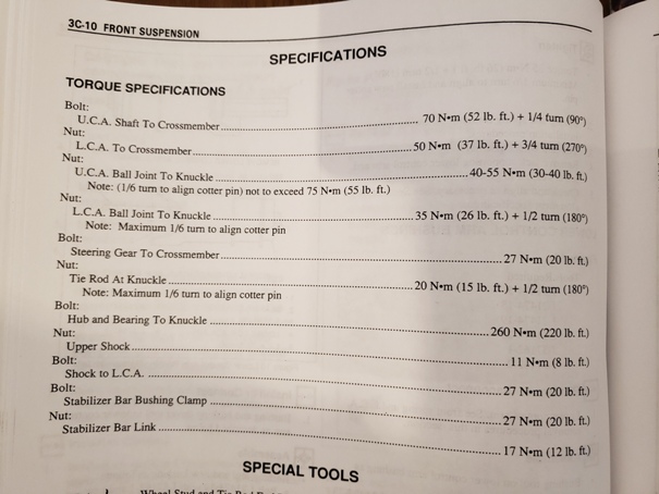

I'm replacing the PS rack and need the tie rod torque specs. I ordered a manual but it won't be in until end of the month.
Dr Xtreme
jonnyp
OCT 15, 12:31 PM
See pictures from Haynes Chapter 13 Supplement for 1988 models years and the 1988 Service Manual for front suspension torques. Both state 15 ft-lb. plus 1/2 turn.
