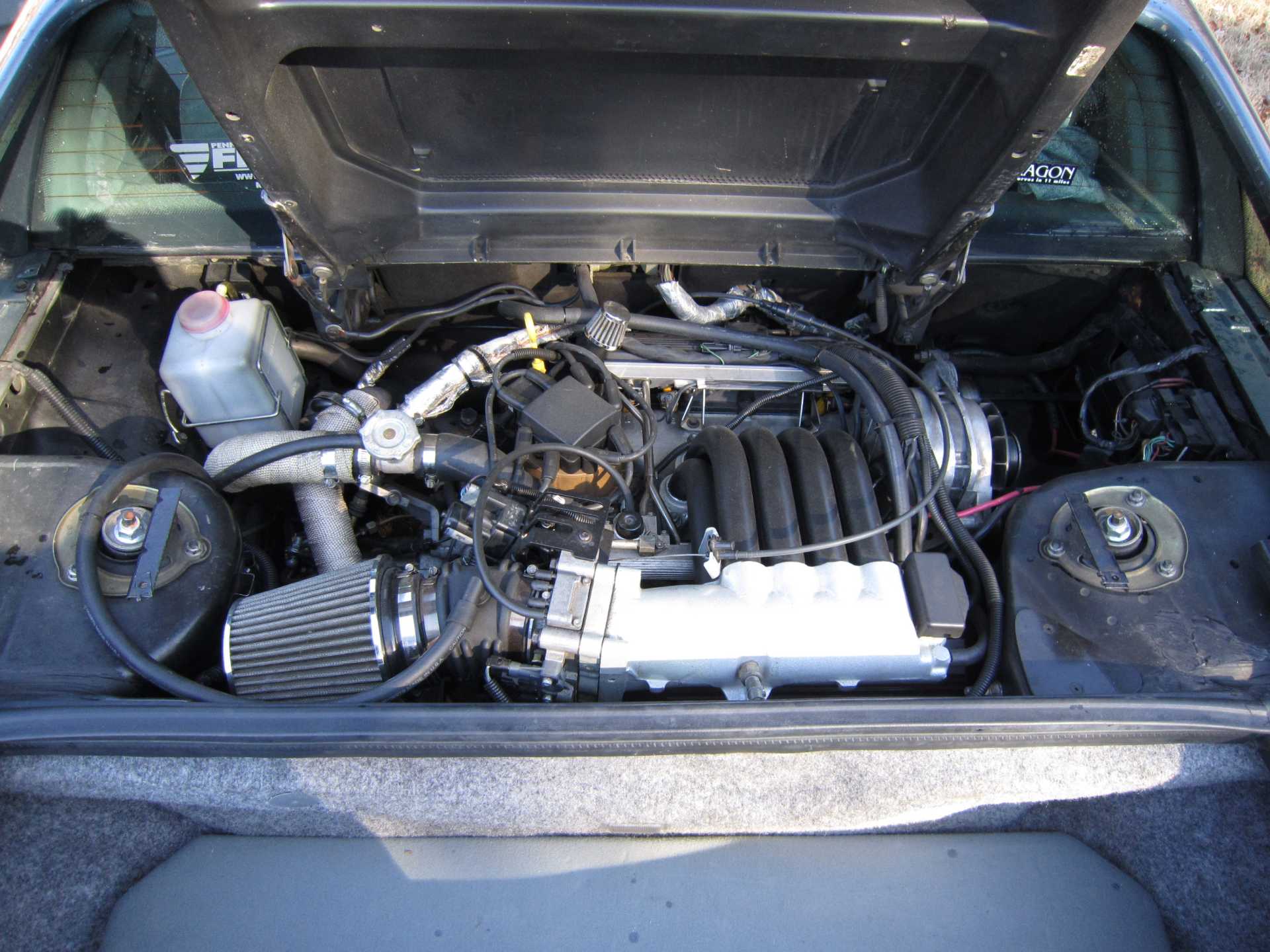

I've got a 4.9, but unlike you, I was having trouble with the coolant running out from the front cap. (I had the correct cap. Probably had to do with the grit in the sealant tabs that GM recommends for the 4.9.) Anyway, I put a 20 lb non-vented cap (no little disk in the middle, either) and added a fill adapter at the rear. I placed a coolant bottle where the stock air filter canister used to be, and put the regular 15-16 lb cap on the fill adapter. I haven't lost any coolant since then.

Makes sense, Ogre, and that's a clever solution, Raydar.
