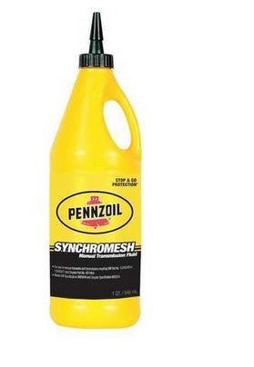

You need some of this. Drain your old stuff out (on a warm day) and add this. You'll think someone rebuilt your trans. The factory also recommended it as well. Do a search for more info.

Yes. Use right oil in the trans = syncho oil shown above. Many use "gear oil" GL4 or GL5 and will cause problems
