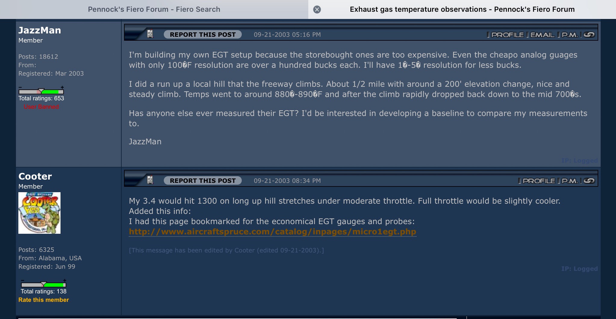

Found this under exhaust gas temperature.

At night, both manifolds (well, what I can see of the front one) on my Fiero get a visible dark cherry glow after sustained highway driving. It runs like a top. After a few minutes of city driving or idling the manifolds stop glowing.
It would be bizarre if both your banks aren't working the same.[This message has been edited by pmbrunelle (edited 10-26-2020).]
OCT 26, 08:15 PM
Ed Parks, I believe, made the statement that, in a dark garage, it's quite normal to see a slight glow from the Fiero manifolds.
When I was breaking in my cam (fast idle) I lit those suckers up.
If it runs decently, I wouldn't sweat a little bit of a glow, as long as they're not bright orange or white. With that said, you would think they would be at sort-of similar temperatures, if everything is working properly.
