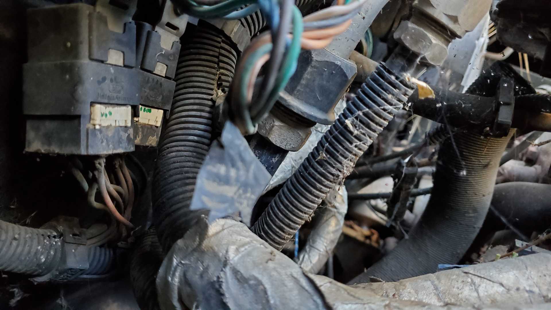

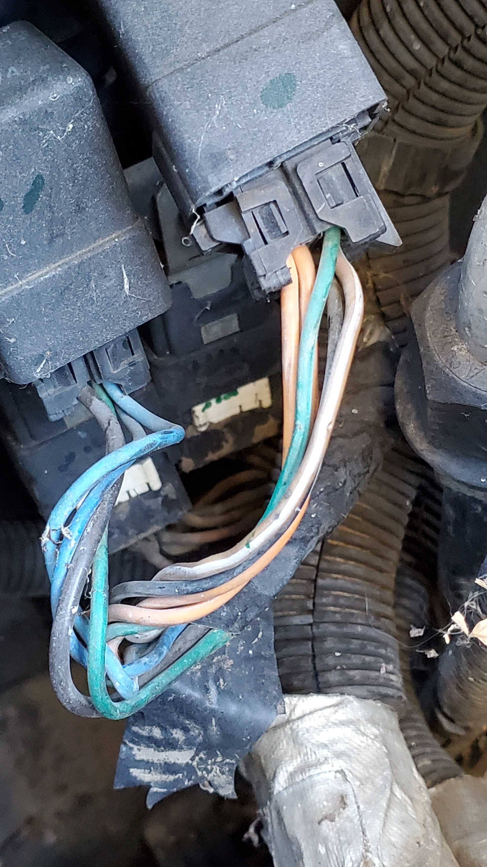

Hey all, just dropped the tank and have all the hoses disconnected one way or another. The only thing left is the wiring and the fuel pump relay to disconnect. The only thing is I can't seem to find which relay it is. I've looked all over in my manual(s) and I can't find it, and the 84's wiring is very different from other years. The wires also seem to go into taped or wrapped bundles, so how do I get the tank and the wires free?

Tank wire disconnect is 3 pin weather pack (C502) on firewall just above the tank tunnel, below two wire bulkhead pass thru seals. ------------------ Dr. Ian Malcolm: Yeah, but your scientists were so preoccupied with whether or not they could, they didn't stop to think if they should. (Jurassic Park)

Listen to the ogre! The connector can be a heartbreaker to find, but if you follow the wires up to the engine compartment, you will eventually find it. I've disconnected and re-connected it both from under the car and leaning over it, but you gotta want it.
